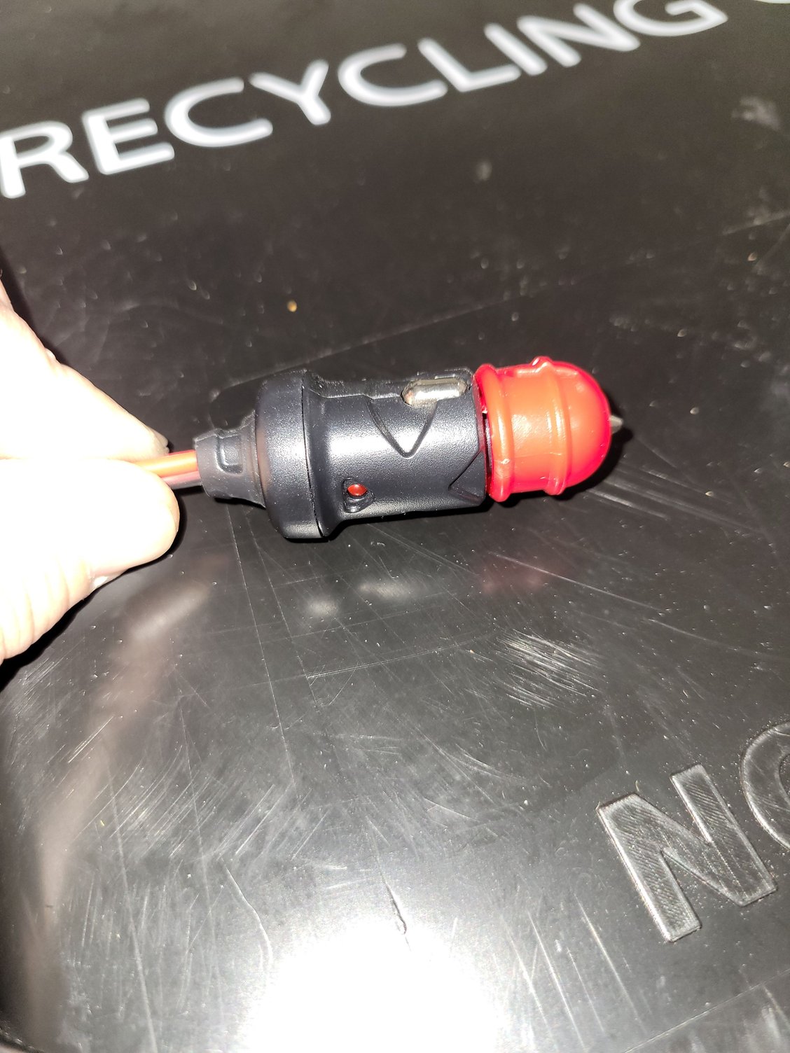

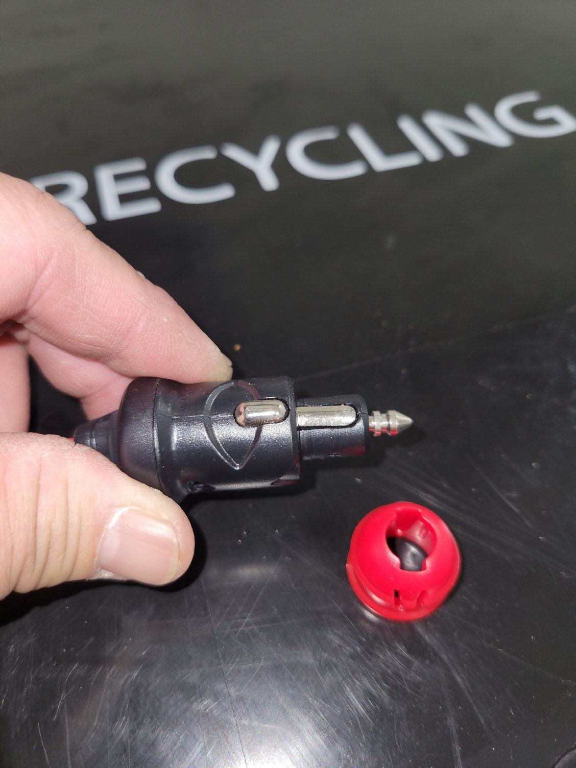

I had the same issue with it going off and on with my Noco. I removed the ring and shortened it. Works for me now.
https://www.lifewire.com/cigarette-l...-socket-534783
Can you explain further?

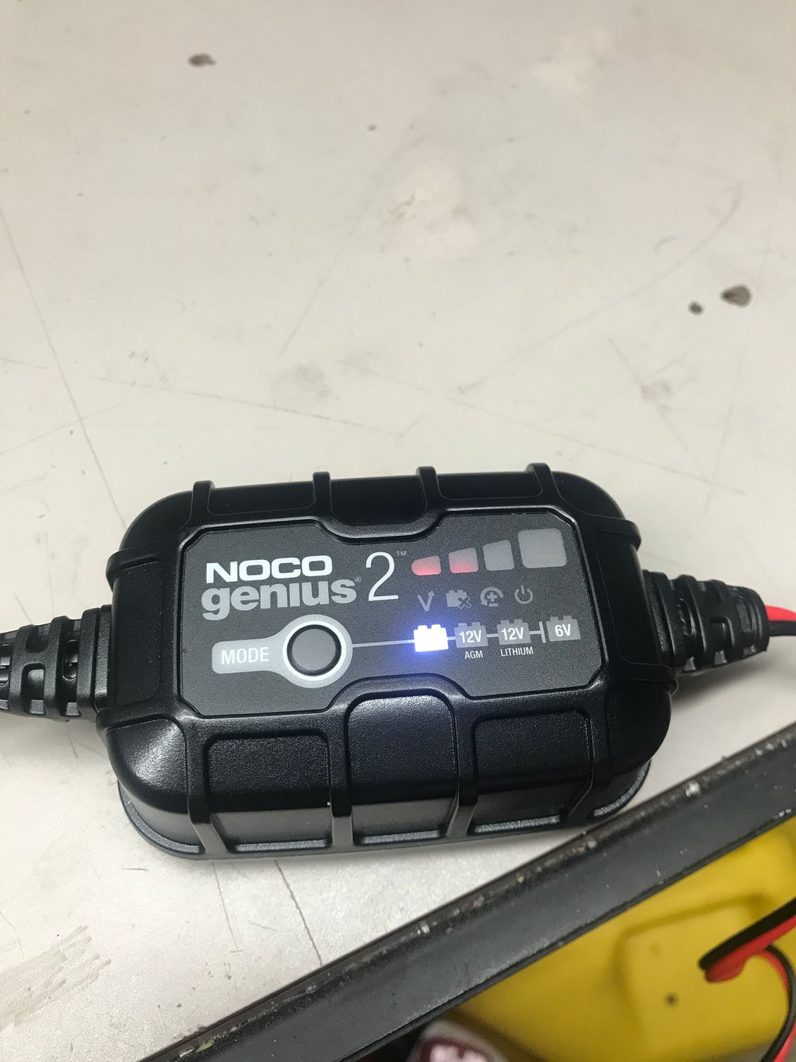

I got a Noco one. It has the adapter that will go both short and long. Short seems to work better and doesn't come loose as much. I have Lithium and AGM batteries so that is why I wanted a unit that will do everything.
THIS and THAT with the Doohickey with the red ring removed.
I use the Noco charger as well. Keeps a trickle charge on the garage queens just fine.

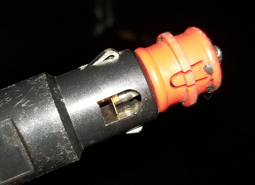

Originally Posted by Gearhead Jim
OTOH, the receptacle in the trunk feels even cheesier than the CTek male plug, hard to tell which is causing the problem.
That occurred to me, too, but the Deltran BT+ with lighter adapter on my first C7 never gave me any problems. When new, the Ctek connector had two plastic guides, or whatever, on each side. My best recollection is that they were black plastic, but these broke off in short order. The warranty replacement broke off, too, and you can see where they were in the photo below, so that might be the root of the intermittent-connection issues. Again, I haven't bothered to replace it again since it's out of warranty and the problem is only a minor irritation since the CTek LEDs are visible every time I walk out the door into the garage.
As you say, since it disconnects on a whim it would be of major concern if the car was stored and frequent checking made more difficult. I've thought about taking the Deltran adapter and splicing its connector to the CTek, but it isn't a big enough problem for me to hassle with.
I don't recall if the little plastic fingers (missing in your photo) on our first CTek had broken off or not, but our current one still has them in place and still loses connection sometimes for no discernable reason.
On our first CTek, I tried various sizes of rubber O-rings slipped onto the red tip, but didn't get much improvement. Some were too small to make any difference, others were too large and got the plug stuck in the receptacle. There might be a "just right" size but I couldn't find it. CTek also sent me a new red tip that didn't help, which makes me suspect the Corvette socket is part of the problem. Or if Tinkertech is correct about the design, then the only good solution would be to get a good new male plug from an auto parts store and splice that onto the CTek wires.
