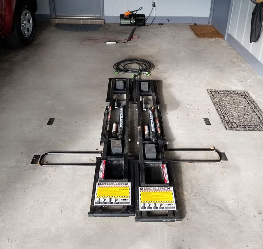

Either one will work. My longer (5000TLX) model works well for my C7Z when turned perpendicular to the car, as shown here...
It also works well in the more "normal" parallel setup on everything else in my garage.
The shorter (5000TL) model works in the more "normal" parallel setup for C7s, but would be too short for many other vehicles.
