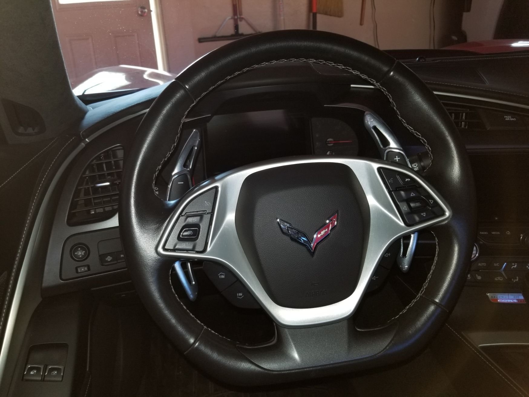

I agree that AFM is a "person of interest" when it comes to drive train breakdowns. I tried the Range unit and found that it worked just fine but there were some peripheral issues that I didn't like so I removed it. I went to paddle shifting and after a few weeks of training it became second nature to me. I prefer paddle shifting.
I forgot to add, adding paddle extensions shortened the learning curve considerably.
