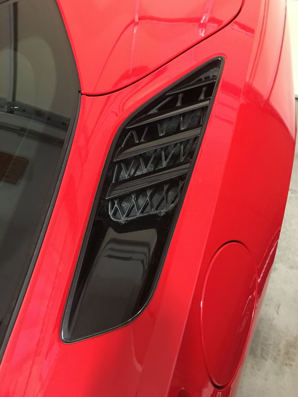

Are these extractors (or actually, I suppose they're intake vents) easily removable? There's a bit of dirt inside of each one, left and right, that I'd like to wipe out.

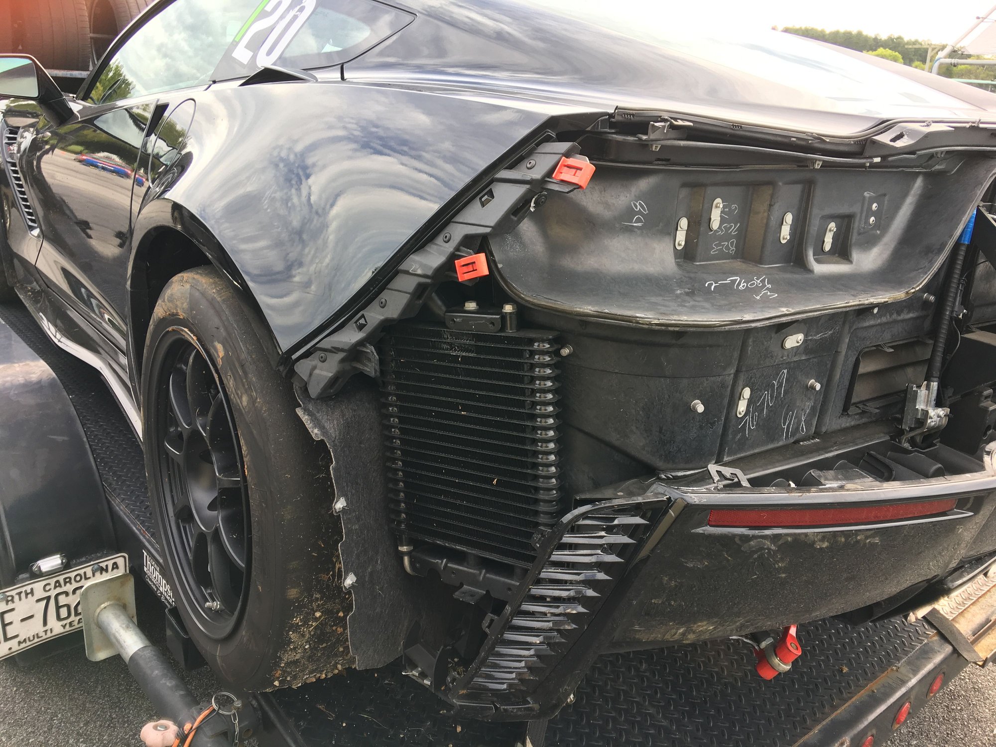

This is what it looks like behind the quarter panel:

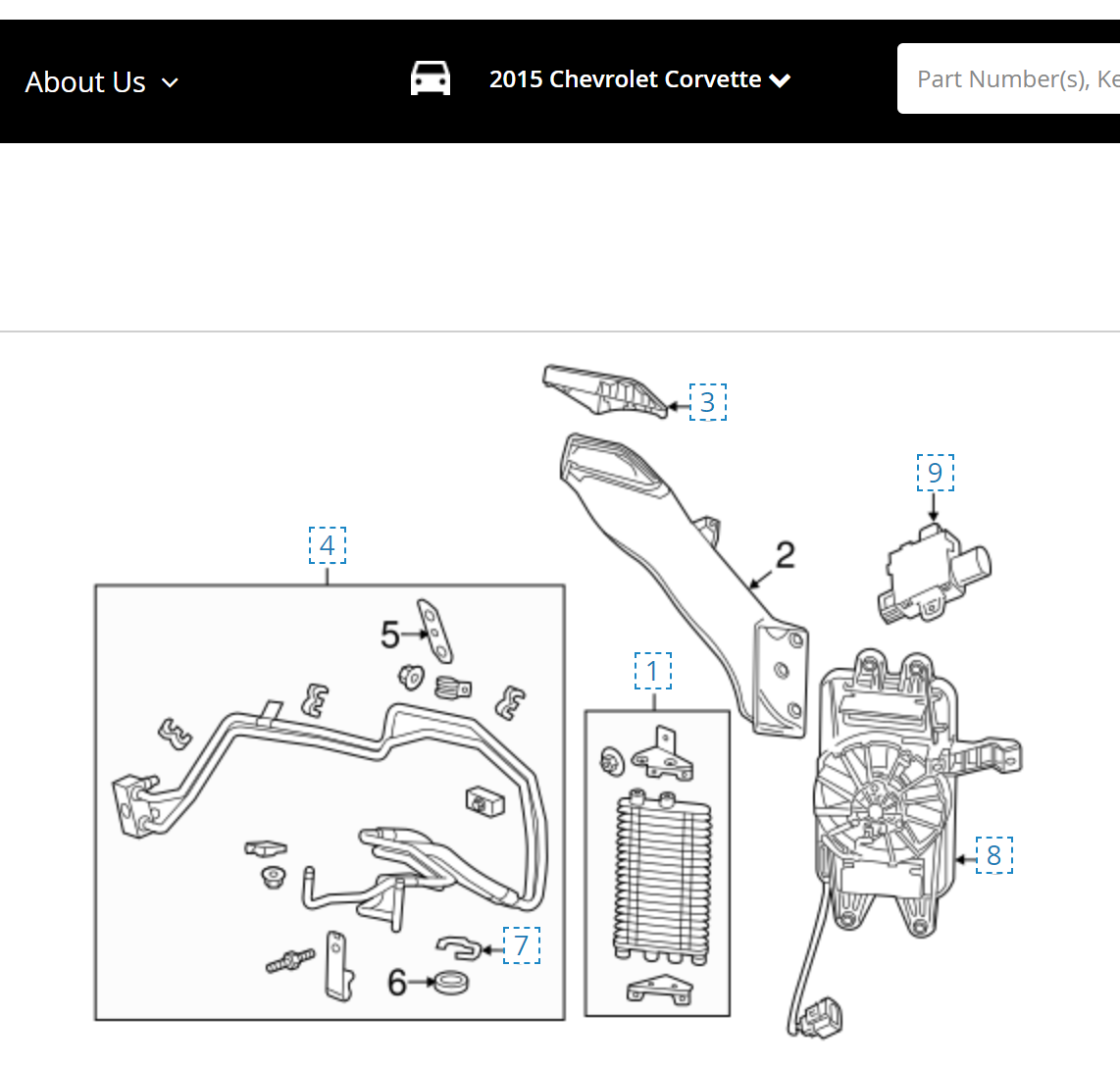

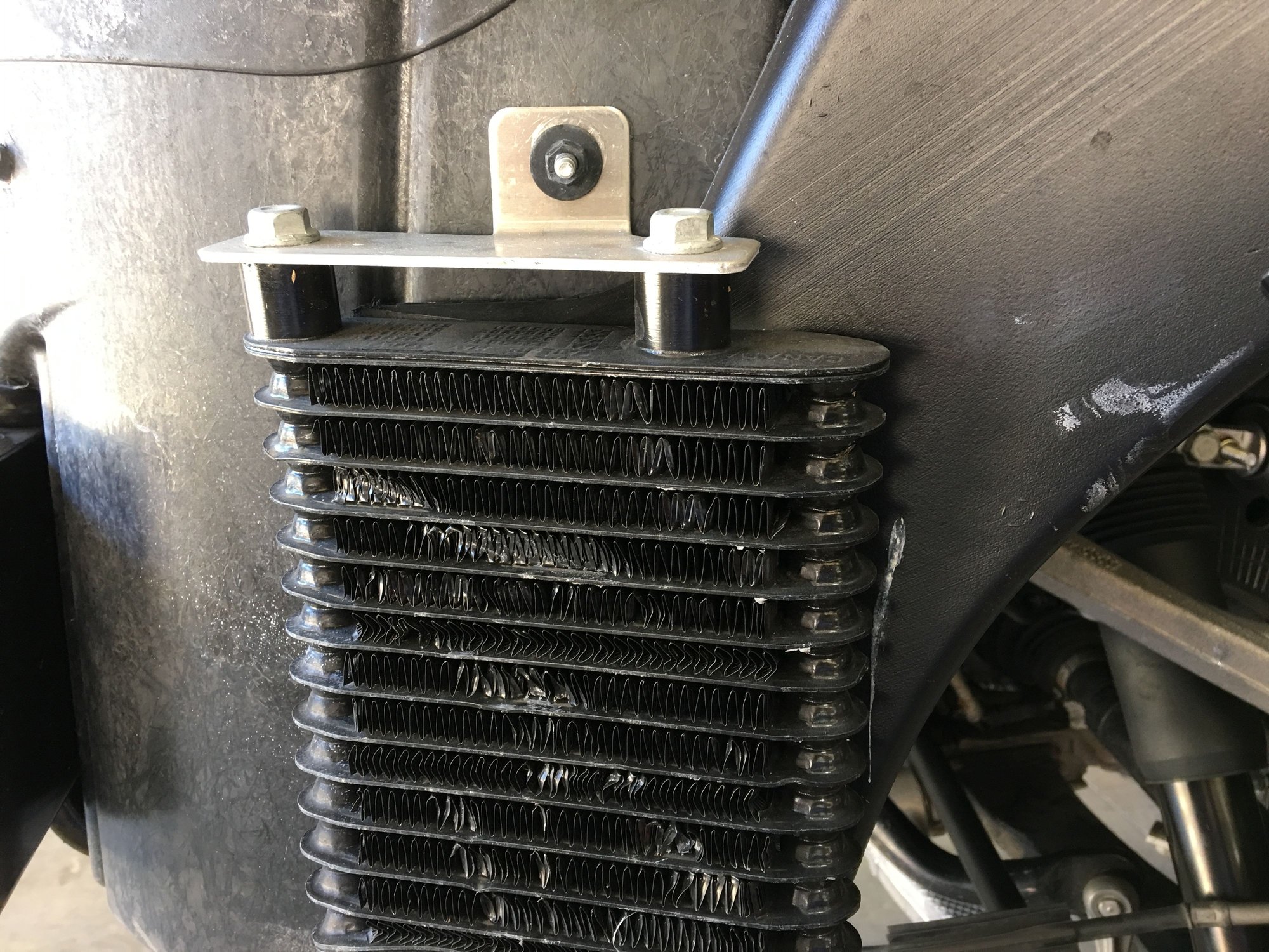

This picture shows the passenger side duct that attaches to the grille. This duct directs cooling air into the diff cooler. The driver's side is similar but that duct ends up forcing air through the transmission cooler as shown in the following picture:
This diagram shows how the driver's side duct (Item 2) fits under the quarter panel and feeds air to the transmission cooler on both manual and automatic transmission cars.
