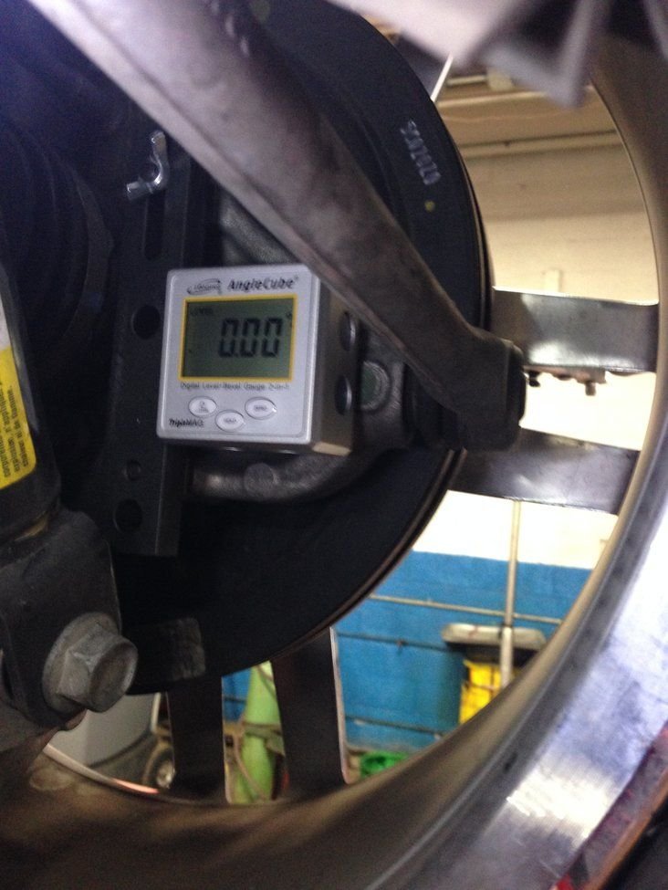

I made a caster fixture with some stuff I had layin' around. Two pieces of strap steel, balsa in the middle, carbon-fiber tubes and epoxy the whole thing together. Got the angle meter online for about $20.
Tubes are wrapped with a little 3M blue tape as they were just slightly undersized.
