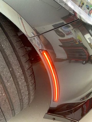

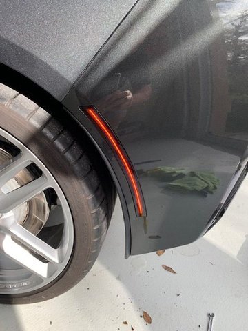

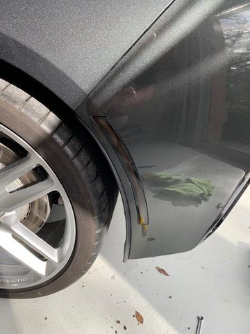

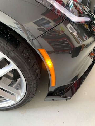

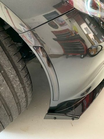

Thanks..... Before and afters..

Sleek for sure. I had them on my old 5th gen Camaro.

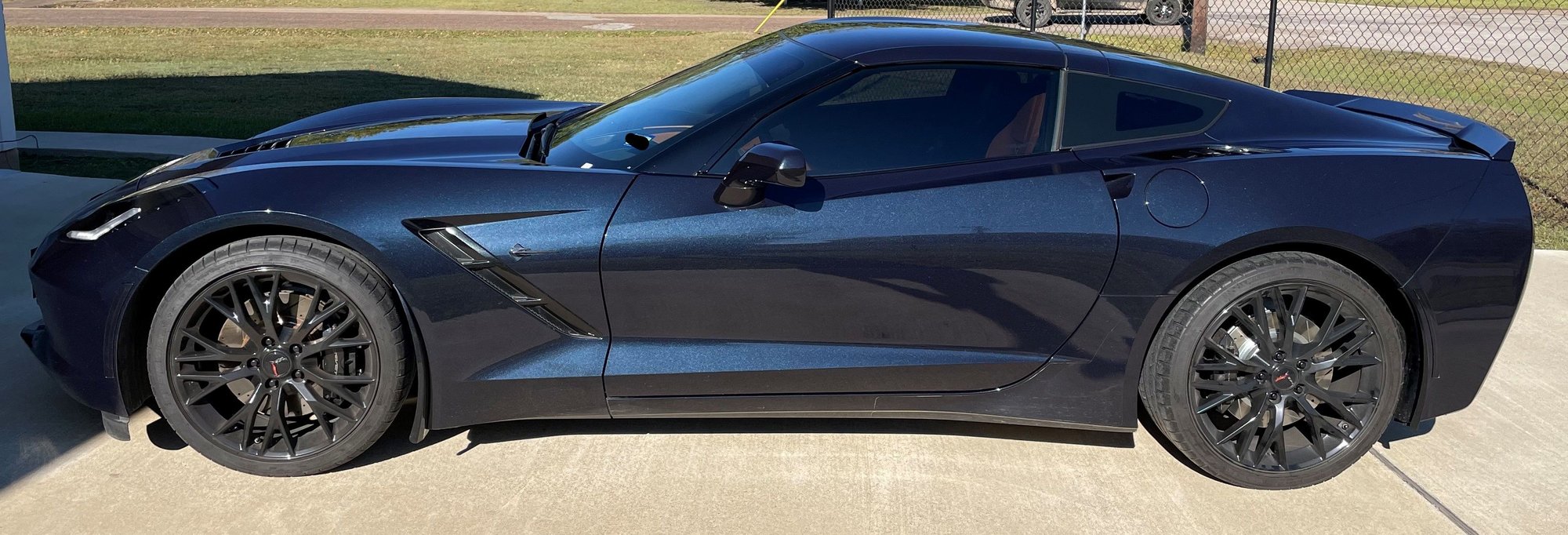

I have a 2016 NRB and bought the body color oracles.
