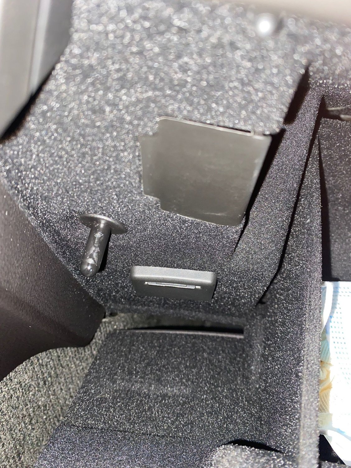

MyLink is an overall infotainment control system. There were two Navigation style systems available for the C7. If the car wasn't ordered with the optional NAV/PDR it gets the Nav function through On Star Turn by Turn Navigation which is a subscription service. The car referenced is a 3LT which just like the 3LZs has the built-in optional Navigation/PDR module. Like I said in my previous post you need to verify what you are looking at by knowing the Trim Level or by knowing which options were purchased. There are many C7s that were ordered without Navigation/PDR that only have navigation provided through OnStar. Over the years, people searching for cars that have the PDR have been advised to determine if the car has Nav since the PDR is included with the Nav. Salespeople will say that a car has Navigation when all it has is OnStar Turn by Turn Navigation. This has resulted in some forum members finding out after they purchased a car that it didn't have the PDR because they didn't understand Nav isn't sufficiently defined. The only year the C7 didn't have the PDR as part of its optional Nav unit was 2014.
One way to determine if a car has the optional Nav/PDR is to look in the passenger side glove compartment. On the panel behind the left side of the glove compartment door, you will see an SD card slot. That SD card slot is part of the PDR system, if you see that slot you know the car has both Navigation and the PDR. Here is a photo showing the SD Card Slot behind the Glove Compartment door.
Bill

Don,
Bill
Okay, that makes the determination a lot easier. In the narrative of the car's description it does say that it has "Performance Data & Video Recorder" but I think that it still would be wise to check.
