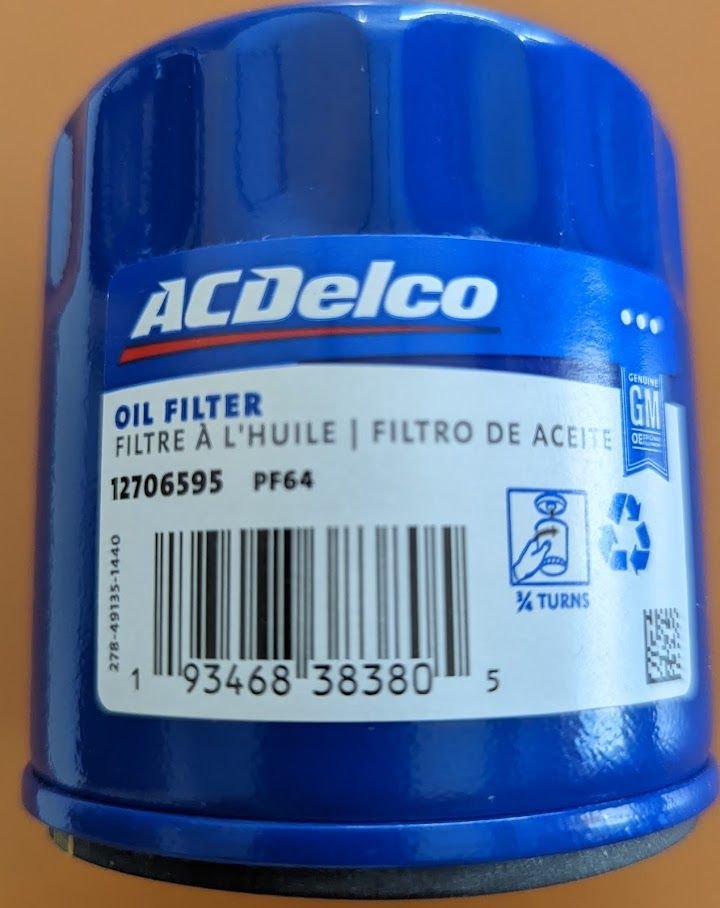

I got 2 PF64 12706595 from Rock Auto and is product of USA.

Got the latest (supposedly greatest) PN 12706595 at Wallyworld 2 weeks ago. $7.28. The box has markings in multiple languages and the English part claims "Product of U.S.A.". It's the same as the previous ones I got for the oil changes last August and November.

@wrecker3 Your filters as pictured look exactly like the "AC Delco GM Original Equipment Gold (Professional)" Oil Filters from RockAuto that I received unboxed in December 2021. Open Oil Filters from Rock Auto .
Did it concern you that your filters arrived from Rock Auto unboxed and otherwise unwrapped? At the time I was seriously concerned they were foreign knockoffs.

On the top of the can said "Product of the USA". I would think they get them cheaper by the unboxed case. I looked at Advance Auto Parts and the filter looked the same. I used this filter for all most a year have had no problems.

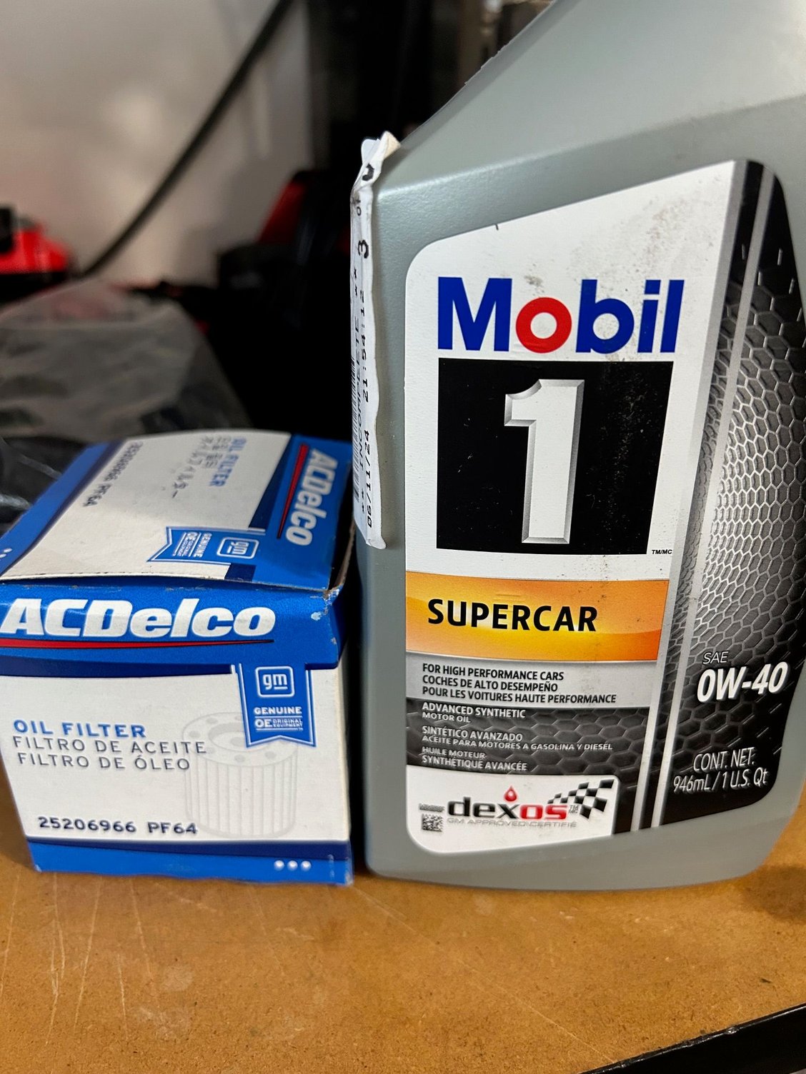

Yeah....... even though this is a very old thread, it STILL seems like every year, I get a different part number for the PF 64 filter.
Today's filter just arrived with my 8 quarts of Super Car Mobil 1 0W 40 oil. Today's filter shows a part number 25206966. It also looks a bit concave by design on the side that goes to the engine compared to flat type on previous part numbers I've seen for the PF 64 AC Delco filter.
The past 3 years, I've bought oil from AutoZone buying the package deal that you got 5 quarts of Mobil 1 ESP X3 oil and a STP filter, which I return to the store. I can no longer find the deal, or even that specific oil at Auto Zone any longer, so I bought Mobil 1 SuperCar oil and the PF 64 filter from Rock Auto. Very good price for the oil and filter, but was surprised to see this "new to me" filter part number. Hadn't see this one before.
New PF 64 Filter received from Rock Auto
