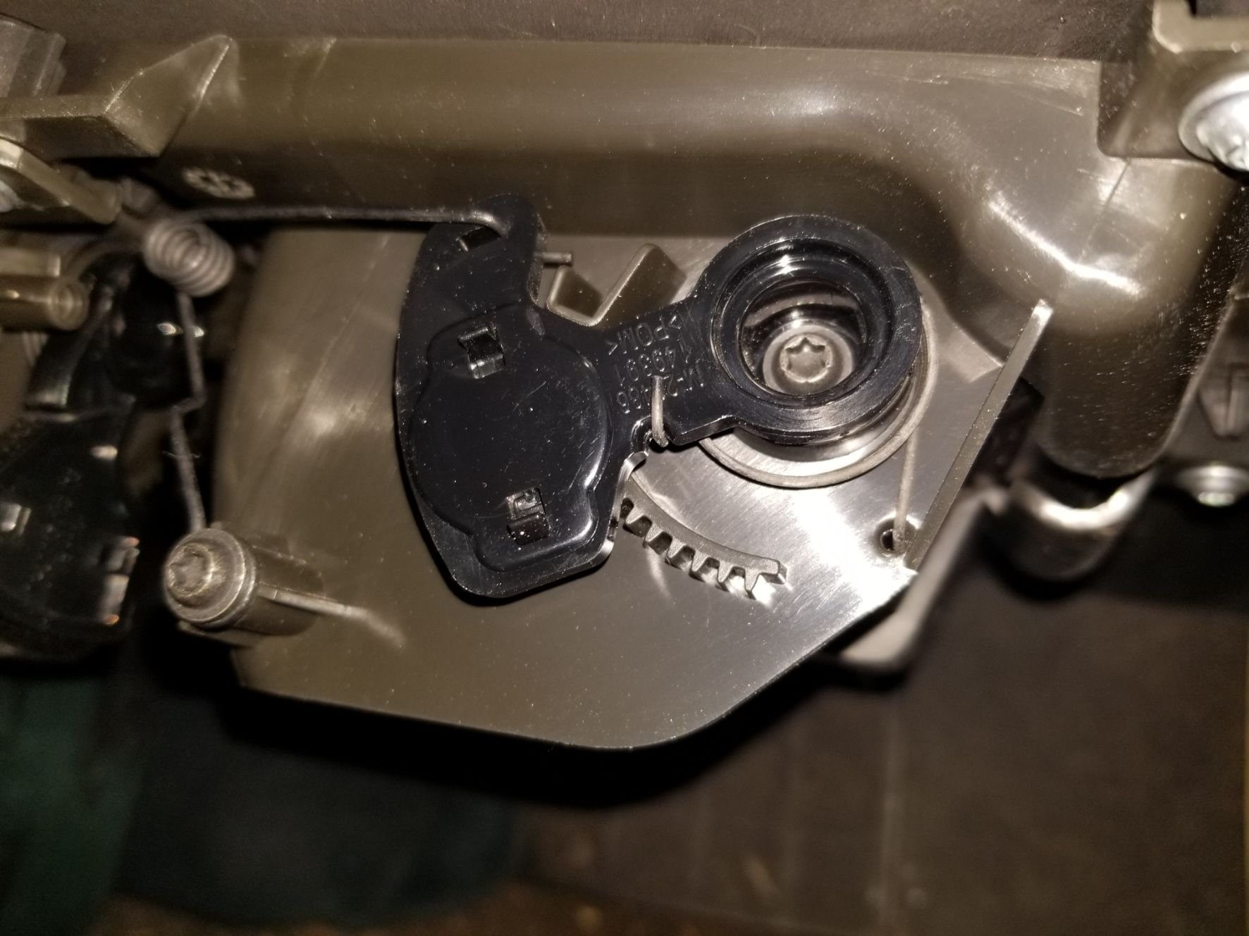

My 2016 Stingray center console cigarette lighter cover won't latch down. Stays open all the time. Is there a fix?

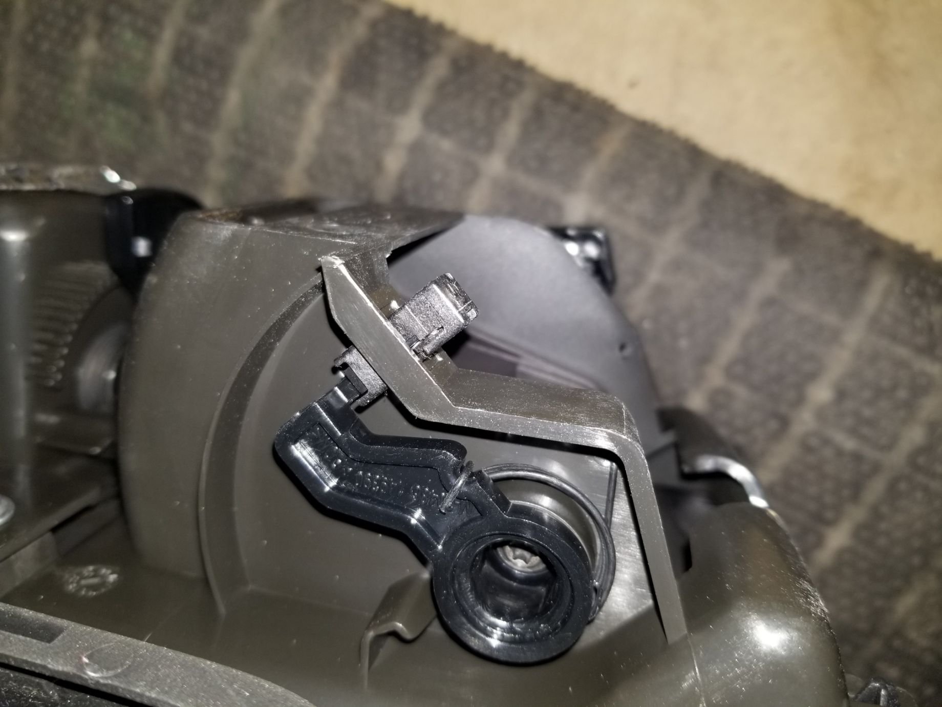

You have to remove console. I would suggest looking online like youtube to find a video of carbon fiber dash swap. In those videos they will show you steps as console is part of the steps. I will say if u have an automatic, the putting it in neutral and pulling sharply up can be a pain. First time I did it pulled too hard and spent the next half hour trying to find the little whit lenses for my shift indicators (lol) Pretty Easy, but do it in a warm environment as not to break any tabs. I would not attempt anything in a cold garage. I have a few pics below of mechanism.. the second pics shows the mechanism your looking for. It is a latch that catches when you close cover. I hope this points u in the right direction.

Great info. Thanks for the pics. I will look into this.

Thanks for the pics. Never having the console apart, it is kind of hard to visualize exactly what angle I am looking at, but still interesting to see what things look like under the cover.

lol it's upside down looking at sides to take pics.. it's what's on the sides underneath the power socket pop up
