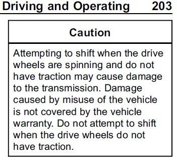

My '19 Z51 A8 behaves the same way. I attribute this to fact that the ECM cuts the ignition for a few
milliseconds at every shift to reduce the load on the clutches. This is the reason for the "bark" on
full throttle upshifts as the unburned fuel in the exhaust manifolds ignites. It is also possible that
the ECM is programmed to reduce power for an upcoming shift when it "sees" the extreme
difference in wheel speed F to R even though traction control is off. Obviously GM wants to
keep as much of your warranty money as it can and does what it can to minimize power train
catastrophes.
