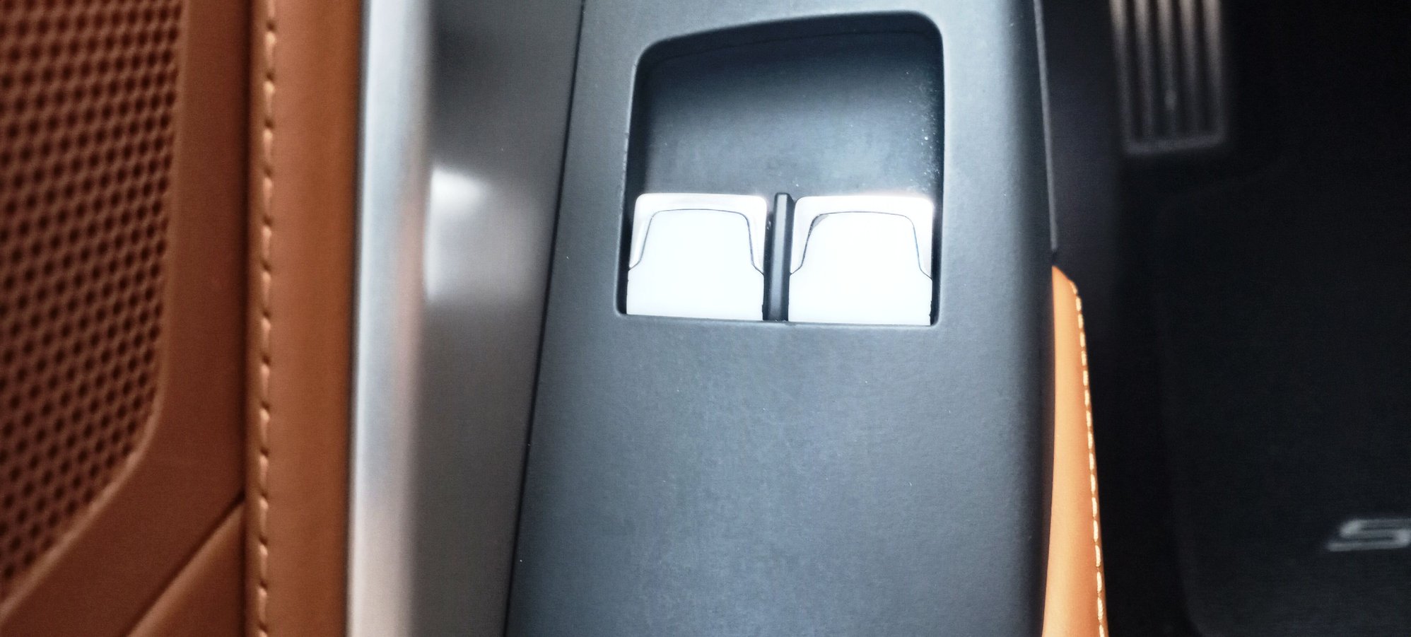

I have a 2015 Coupe, bought used. Ever since I've had it its been missing the "little black window indictors covers" on the drivers
power window buttons. It doesn't effect the windows but it looks strange and a little too bright at night, my passengers side is normal with the cover. My question " is there some cover that is sold or sticker, instead of replacing the switches" ? How did these things come off anyway?? LOL

Have not heard of any covers being sold for the window switches. Perhaps a small piece of vinyl wrap in black would work to cover the shiny areas - certainly cheaper than a new switch.

I would just replace the switches. That whole piece pops off with a trim tool. It's only held in by spring clips. Pop it off, swap the switch module and on the back, and snap it back in place. Whole thing should take 15 minutes.
