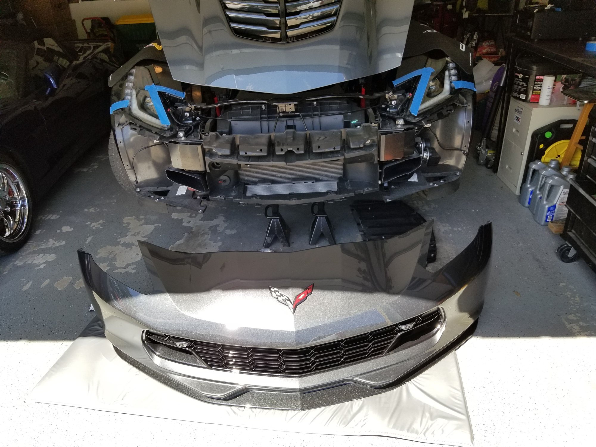

Just took my nose off this weekend to swap in a new grille. Had to move the cameras from the old grill to the new as well. I was suprised at how easy it really was to remove the nose. Several good videos online. If memory serves me correct, 4 screws and two plastic retainers on top, 4 bolts and about 15 screws on the bottom. That's it. Also took me a hit minute to figure out how to disconnect the camera plug.
My only snag was the screws holding the camera bracket needed a 5 lobe torx security bit. All my torx security bits were the normal 6 lobe. Don't know how common this is, but they are hard to find. I found a Northern Tool about 45 minutes away that had them and also found on Amazon. A set on Amazon is only about $10, so might think about that before you start just in case.

Same thing happened. Took a rock hit. Bumper removal is not a bad job. Take your time. A helper is handy to have.

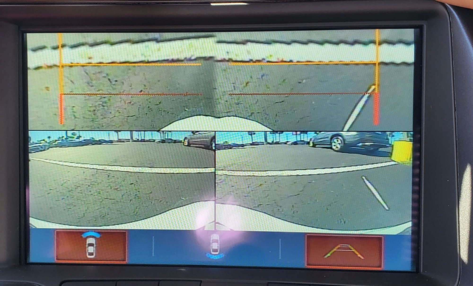

How do I adjust the front camera? They appear out of alignment. Thank you

There is no adjustment to the mounts for those cameras. If something is out of whack, it most likely means the mount is broken or the camera itself is damaged.

Thank you for the quick reply. This is a new grill recently installed at the dealership. Since the cameras came pre-installed on the grill, the mounts shouldn't be the issue. The alignment isn't extreme, just enough out to be annoying. The original was perfect and that was my expectation for the replacement.

I would take it back to the dealer, since they installed it. May not have gotten the mounts seated properly. I did some research before replacing my grille to try and find out how to calibrate the cameras. Couldn't find any such data. When I got into it, I discovered there was no adjustment available in the mounts so no need for calibration. Good luck.

I took it to the dealer today and they have offered to replace the grill. The cameras are pre installed on this grill and the one they have available. We’re deciding if it is worth taking the front apart again for a replacement that might or might not solve the problem.
On another thread Bill Dearborn states “
To calibrate the module to the new camera you need a special camera calibration mat EL-51372 and a GM MDI scan tool to control the calibration process. The procedure in the FSM will work for the Corvette even though it doesn't have a surround camera option. The best price I found for the mat is at https://gmtoolsandequipment.com/en-U...earch=el-51372 for $366.00.
It would probably be a lower cost to take the car to the dealer and have them run the procedure. It isn't difficult but the tool cost is enough to make it a dealer service item Vs DIY. Most dealers will have the mat since it works with all of the vehicles they service and given all of the trucks and cars they sell there are probably a lot of cameras that are damaged or failed they replace.
