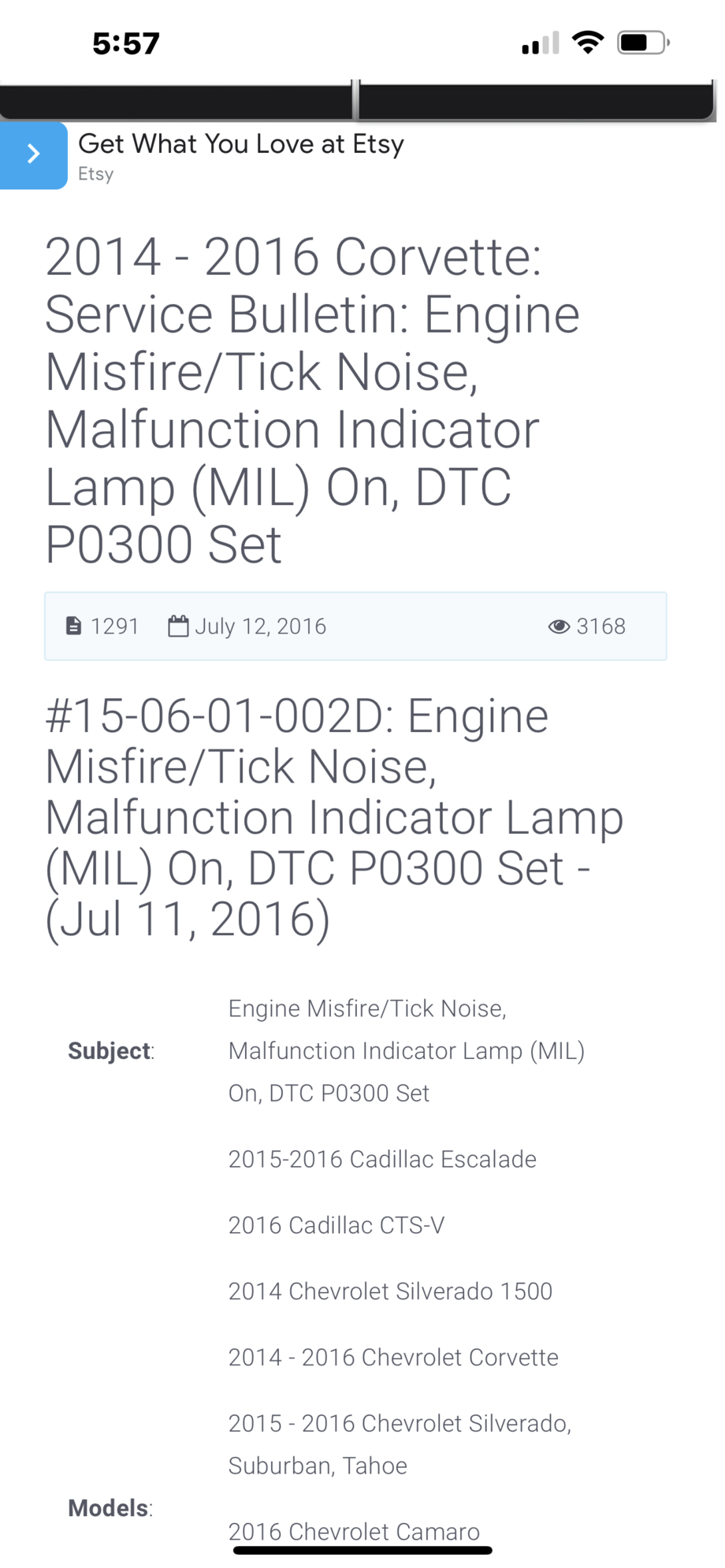

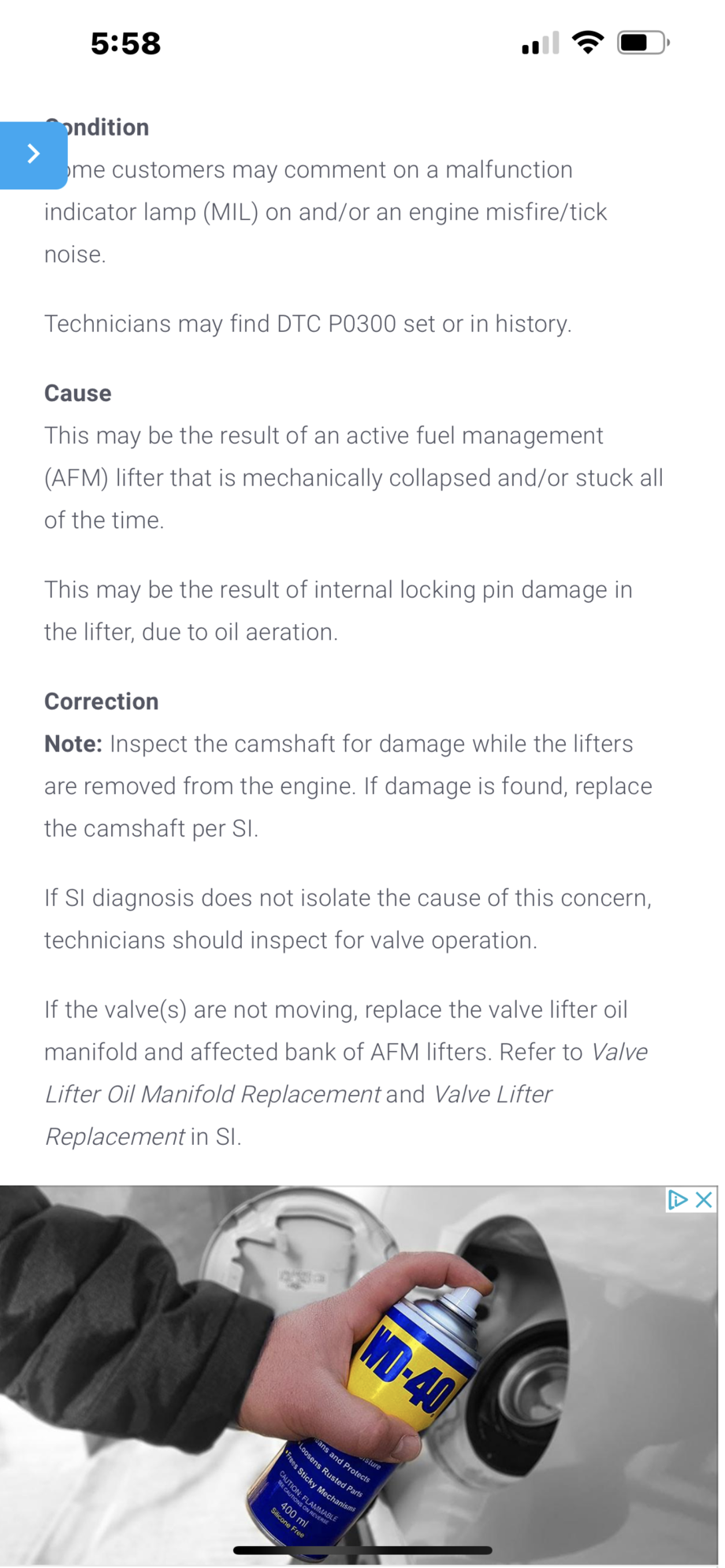

There is TSB for P0300 random misfires for collapsed lifters (DOD lifters) on these engines with AFM…TSB’s are the first thing your shop should have looked at. What EXACTLY did they say was wrong with the fusebox ??…find that strange !!
