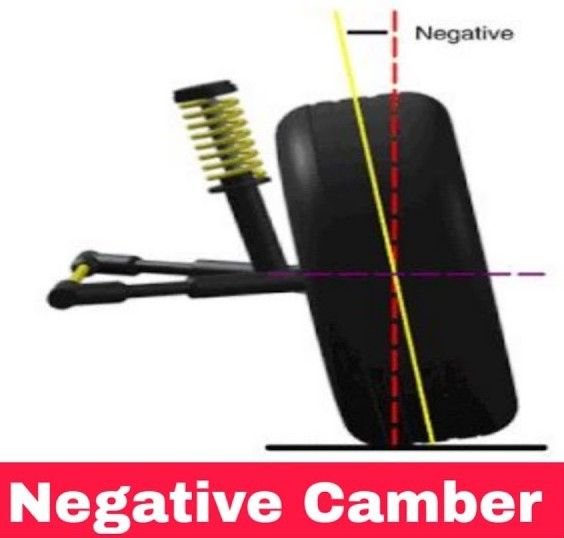

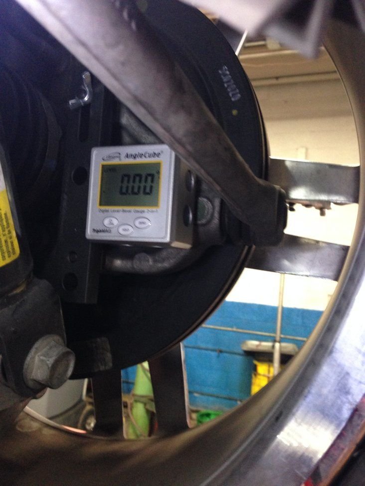

When a C7 is lowered you will get negative camber and will need an alignment and make sure the shop has the tools for rear caster.
