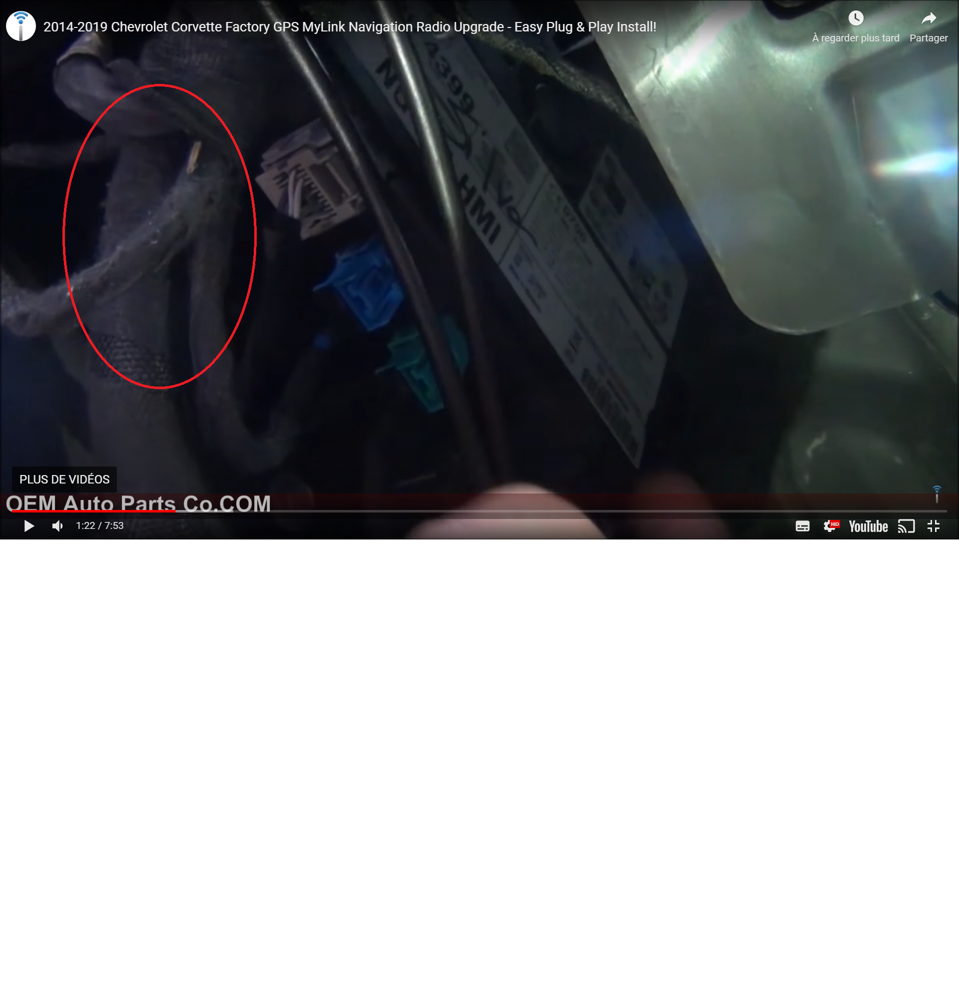

Hi All. Can someone tell me how to remove the HMI module from its support. Should we press the red or yellow tabs (see photo)? thanks. Eric

You push the red tabs back and then slide the module down out of the bracket.

The photo at the top of this thread had the correct tabs circled in red.

After pushing on the 2 small tabs (in red), do you have to pull towards you (inside the driver compartment) before pulling this module down?

I used two putty knives, each placed on the red circled tabs and then slip under the unit. No need to insert each knife very far into and under the unit, just enough so that the knives will stay in place as you remove the unit. Push down from the top of the unit with one hand then slowly pull unit toward the passenger side. It will slide out as long as no wires/wire looms are in the way. Be sure you clear the way for the unit to come down and out. I've used this method a few times as I replaced my unit with an Infotainment IO6. Hopefully you are rather small and thin because the fit under the dash and steering wheel is a tight one. Good luck, Bart.

That's it. The box is out!
In fact, a large black cable on the left of the box interfered with the exit and I had to remove the pull tab from the hood (not sure if that was English...) and the ODB socket to push this cable and finally have the box.

Black cable interfering with the output of the box
