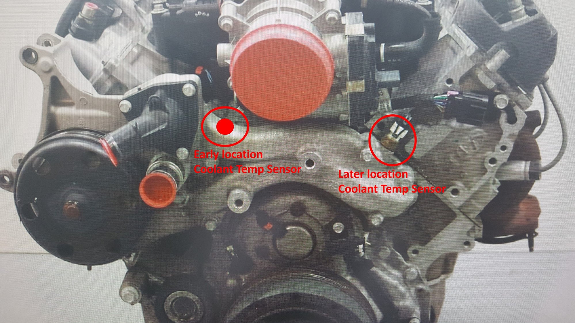

Originally Posted by Z28TOZO6
I dug this old thread up so forgive me gents. new to me 2016 stingray and my coolant was reading 100 degrees. fans stay on has been mentioned here. I bought a sensor to replace it but I watched 2 vids and 1 showed it on front passenger side above the water pump. another one shows it on driver side just under the harness which is it!!
The coolant temp sensor was in one location in earlier C7s, and was moved for later C7s. See below pic. The above pic is the oil pressure sensor (with the horizontal plug).

That settles that
