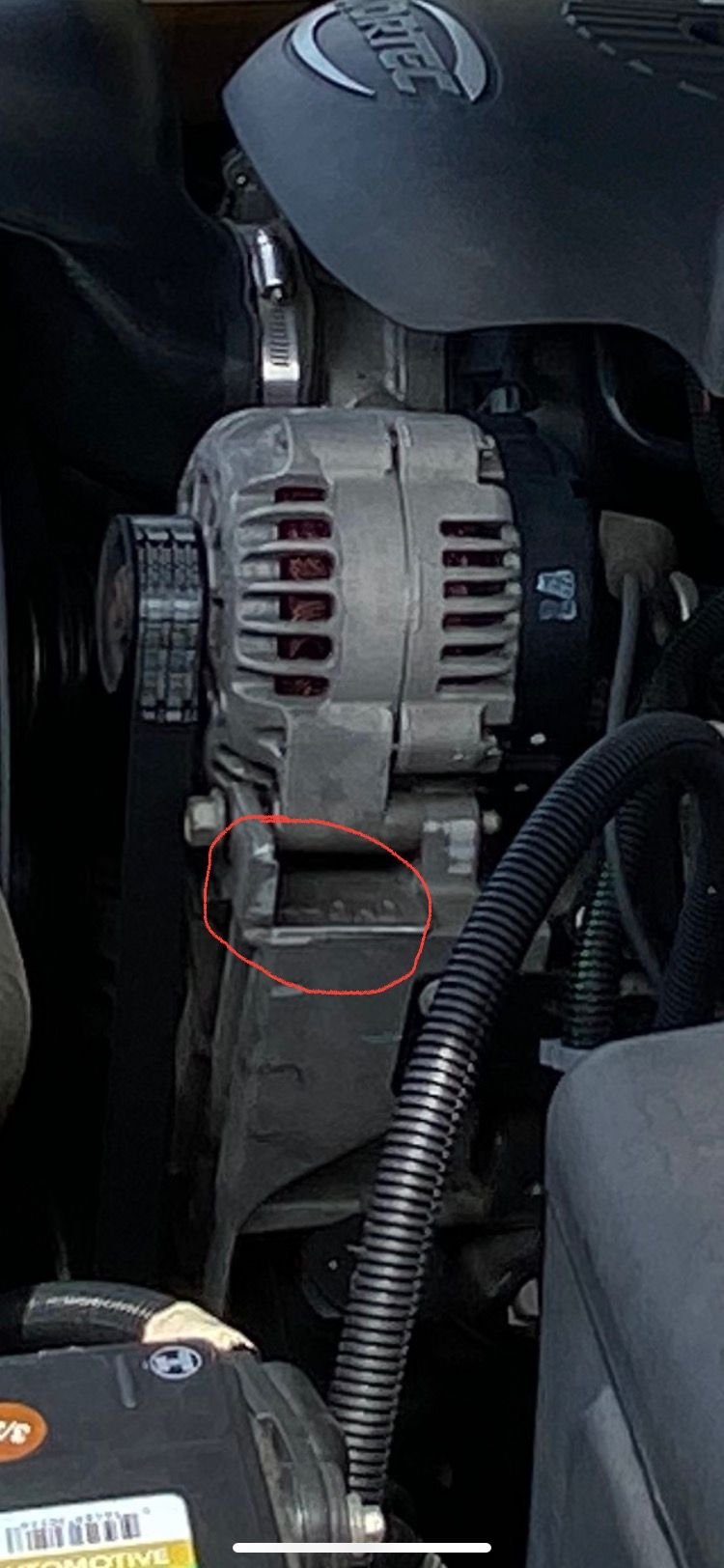

I like where you’d connect jumper cables on my 2004 2500 Silverado. Didn’t connect to the battery at all, very safe.
