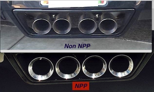

I am looking at buying a 2014 Z51, Do all Z51 have the NPP exhaust systems and I don
t know if it has mag ride and dealership gave no anwsers. Here is the vin 1G1YL3D73E5110692. Can you guys help

It's easy to tell if C7s have NPP or not by the type of tips at the rear bumper. You can tell if C7 has MRC by whether the shock towers have electrical leads/wires going to them. So a couple photos of these areas from the dealer should give you your answers.
