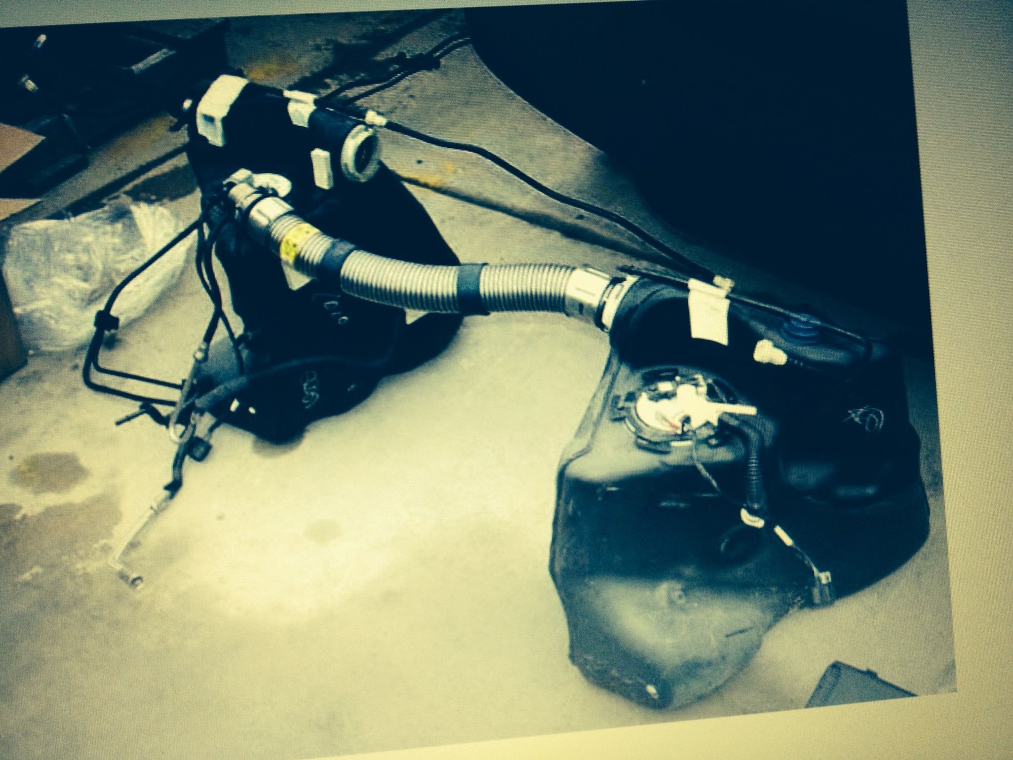

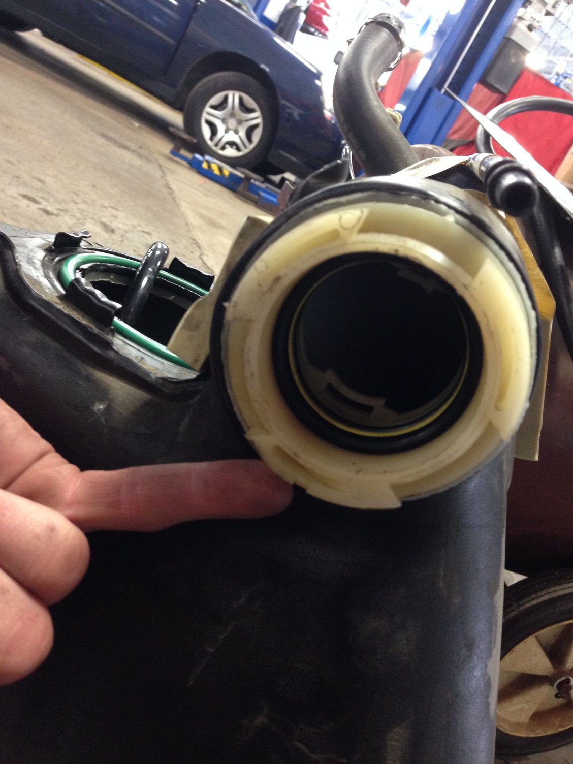

I had that crossover problem on my 04,Started with fuel smell in garage no leak about 4 days later I checked the night before the service appointment there was a fuel leak on underside of corvette floor just below fuel door. There was a plastic part that was defective. Here some pictures if it helps.
Defective part!
Drips of fuel on underside of floor below fuel door. NO drips on garage floor!
Fuel system out of car.
