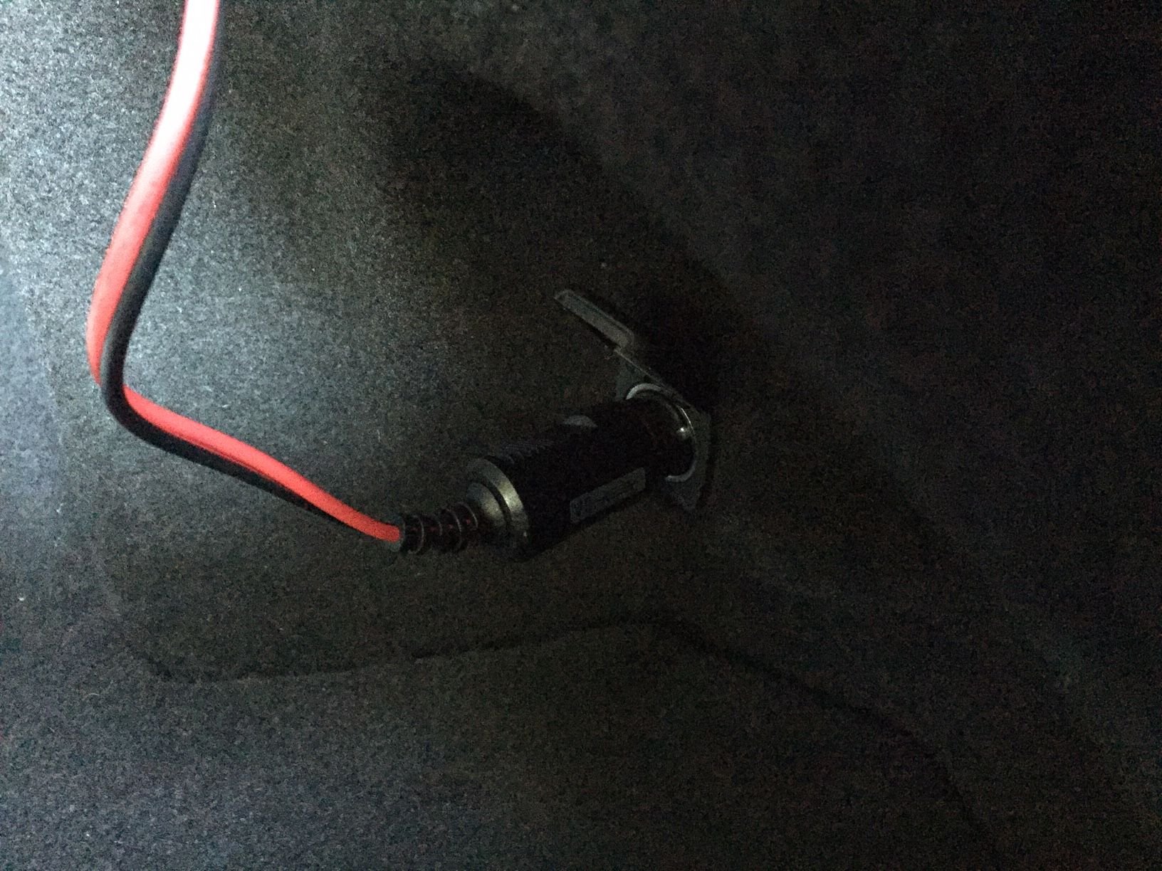

6-8 weeks is not storage, that's extended parking.
As far as your battery, connect to a battery tender, your C7 already has a connection port for it either in your truck (convertible) or hatch area.
Modern radial tires do not flat-spot.
No need for a cover
No need for fuel stabilizer.
The only concern I would have is whether the area where you are keeping your C7 has rodents. Other than that you are worrying needlessly.
No need for a cover
Thank you. I didnt know the port existed for car without battery protection package. Mine does not. Is the port compatible with any tender?
Yes!
