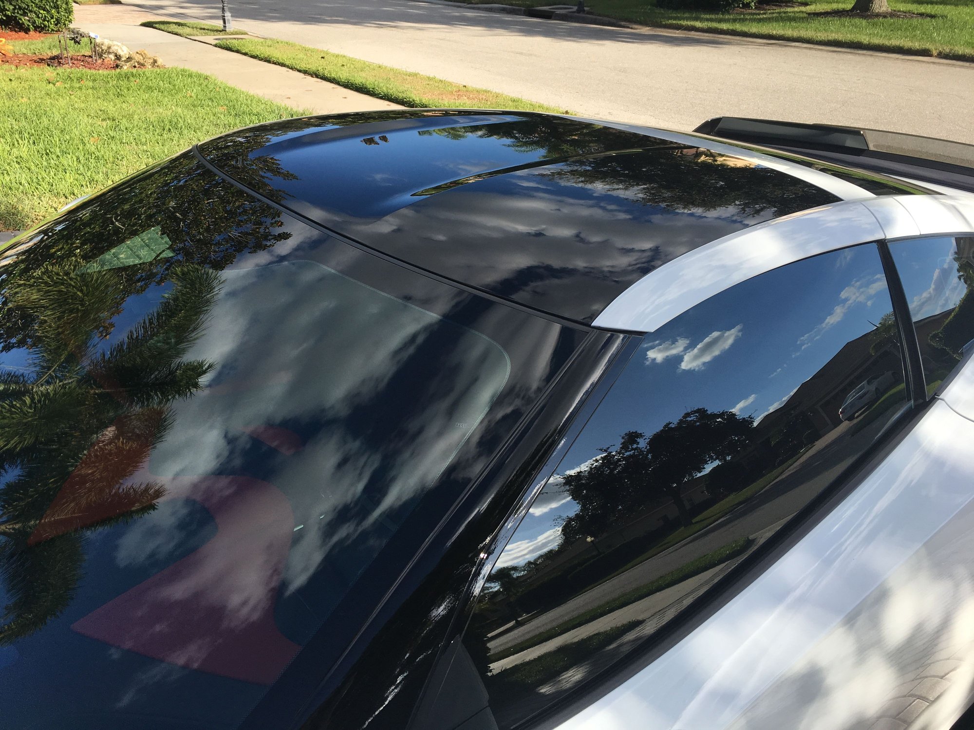

My painter added tinted clear to my top when he painted the side rails to help even out the paint lines.. Happy with the results.
Love the painted strip that completes the roofline profile (been planning to do it myself at some point).
The painted tint is an interesting take on controlling sun heat.
Which got me thinking about film-tinting or paint-tinting when peeling or fading occurs. When addressing those issues in the future, scraping away the old tint or applying paint remover could scratch up the surface. Thoughts?
I'm not sure about the long term impact, however going into the project, it was pretty much a "one and done" decision. My painter told me he wanted to smooth out the paint lines from painting the roof rails and decided to spray a lightly tinted clear over the transparent section. I only run the clear roof about 3 months per year during the Florida winter when the sun isn't that high in the sky as most of the time I run the painted top with my custom stripe. I like the look better plus I like the enclosed cockpit feel and sound of the solid, quilted roof liner. I still have my C5 vert to drive when I want a true to open air drive.

Your car looks really good. What wheels are those?
Thanks. Forgeline AR1s in Transparent Smoke finish. Stock size.
