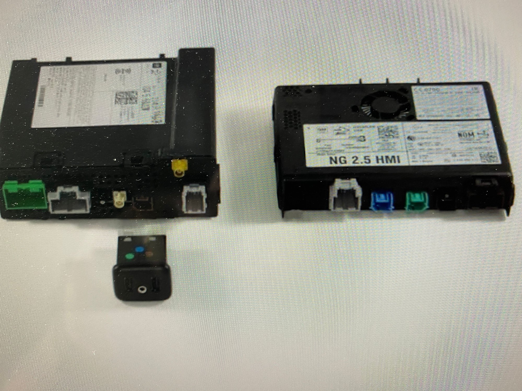

Yes. Several companies offer this capability. There are numerous posts on this topic with possible loss of some other functions depending on if Z51 or not, etc. I did my 2014, 1LT, non-Z51 and had no problems. . You'll need these 3 items (Radio tuner, HMI Module, and new USB port) for the upgrade without factory Nav (I05):
So I have a late DOP 2015 Non Z51 but with Nav and PDR So I would only need the HMI Module?

No, you will still need the Radio Tuner and new USB, but instead of the I05 HMI Module, you'll need the I06 HMI Module.
If you plan on doing this, you need to have whom ever you purchase from, program your VIN into the system.

Just to avoid confusion for some, if you have a 2016 without Android Auto, it only requires a software upgrade.
