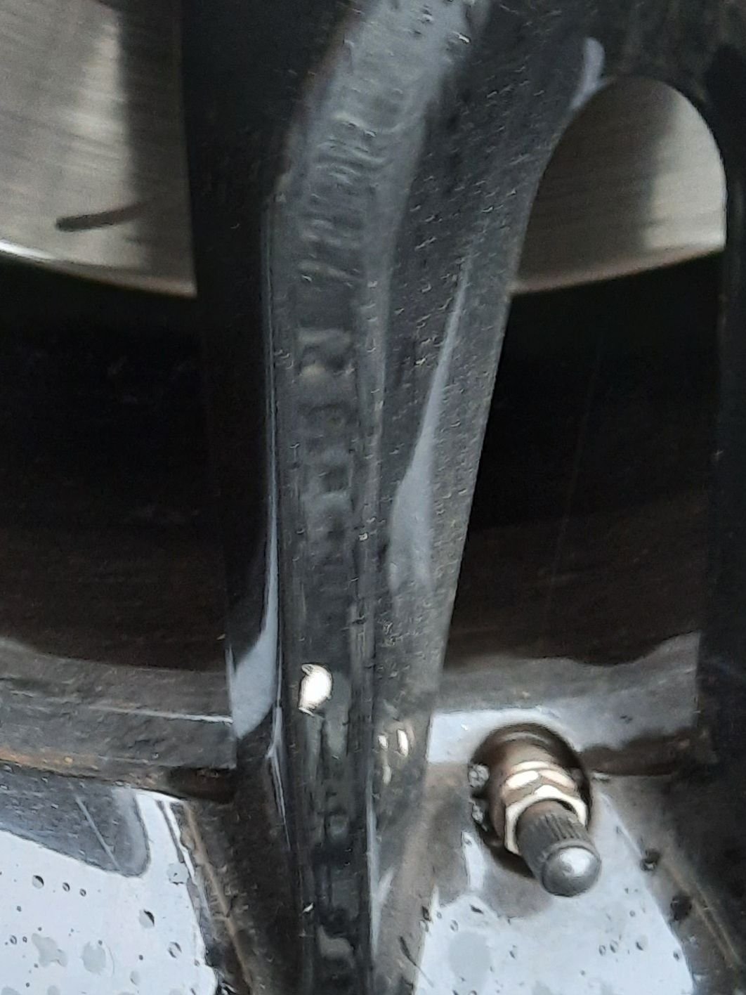

I have a small chip in my Z51 black wheel. How should I repair it? I'm referring to just the white spot in the picture. All the other areas that look like imperfections are actually water spots taken with my cheep camera.

I found that painting the chip with generic gloss black touchup paint worked really well on my wheel. Just keep adding layers & buffing until it looks acceptable.

A black sharpie works amazingly well.

Do as car2fast4you mentions - take your time and it should come out pretty good.

Agree with others, a dab of black paint with a small detail brush will almost make it go away.
A Sharpie marker is fast and less messy than paint, however will not cover as well and fade out letting white return over time.

Is there a need to seal the chip from the elements which I doubt a black sharpie would do. If not I love this idea.

I wouldn't use a sharpie. They often have a blue tint to the 'black'.

Sharpie 100% has a blue tint. Come down to personal preference. For me, if it is tiny then sharpie. If it is sorta big, like in the pic then dabs of paint from a touch up pen. Like $15 for the pen and it will last for the rest of your life. 3 applications and it will be invisible from 6" away.

A sharpie is just meant to be a quick easy fill in, especially for very minor chips. Obviously touch up paint is the superior method. But, I've used a sharpie in a pinch many times on black wheels and it makes small chips nearly invisible and lasts longer than you'd think.
Also, if you use a sharpie and it doesn't look good, touch up paint can easily go right over the top. Nothing to lose.

I don't understand, why would you not just use paint? A Sharpie is not made to stand up to outside elements and will not.

I would use black paint like all the good people here suggested - I can guarantee you that you will be only one that will be able notice it after the repair.

I use Testor's model paint to touch up paint chips in wheels. Find a Hobby Shop that sells it and match the color as closely as you can with your wheels. I've also used Testor's paint to touch up a couple of chips in my red calipers. Buy the small bottles that are used with brushes. I like to use the paint with tooth pics or bamboo skewers to fill the chip. DON'T USE A MARKER PEN (SHARPIE). Color will change/fade as soon as it dries and will continue to fade with time if you put it on metal. I build custom rifles and a sharpie works on NOTHING! Ink ain't paint or rust blueing!

A dab with a small artist paint bush and gloss black touch up paint will do the trick.
