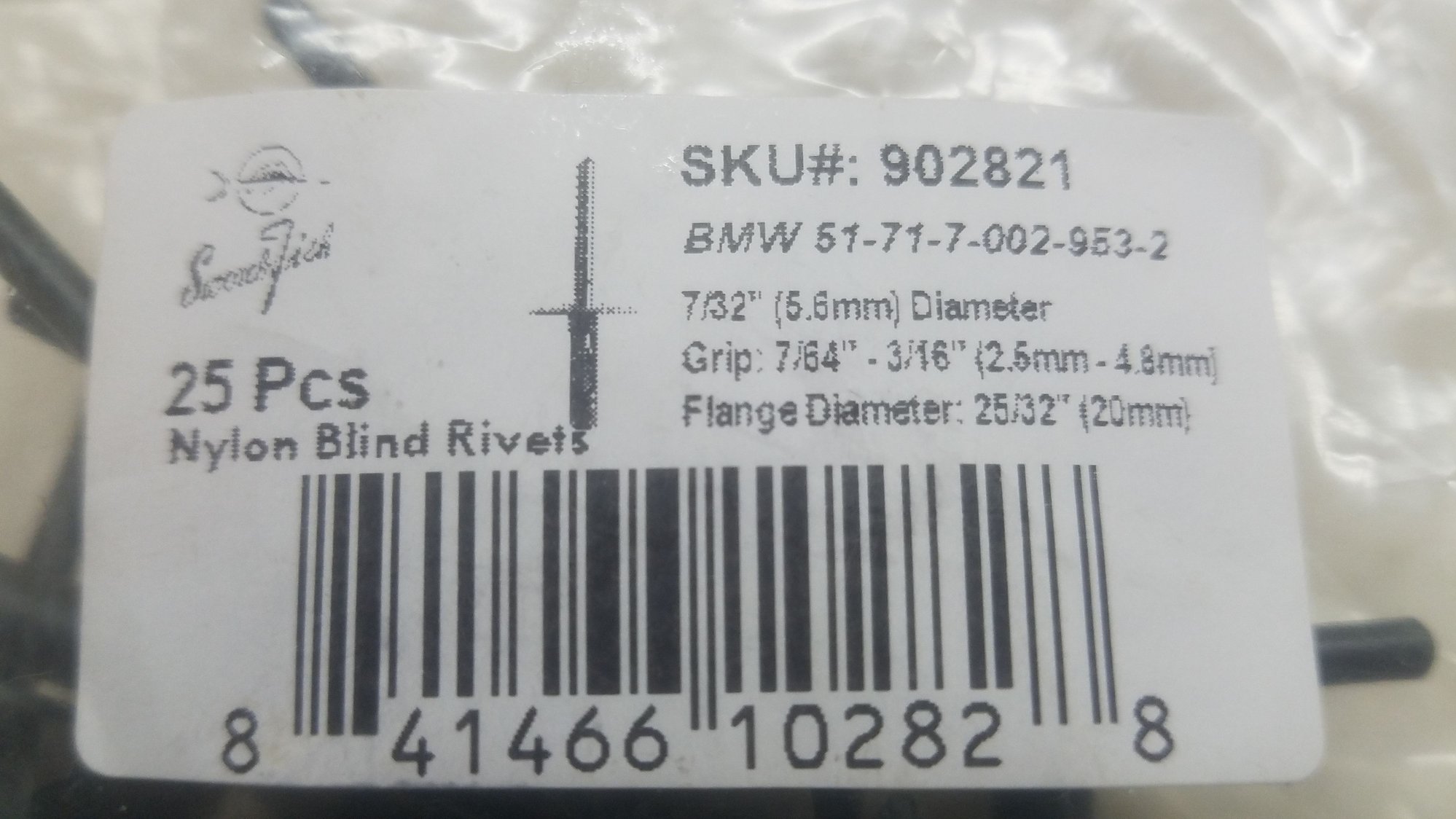

I admit, I am a newb when it comes to rivets, but I got an acs z06 front splitter and I don’t see anywhere what size the rivets are? I have a rivet tool with a few different size adapters but the supplied rivets seem to be too big for all the adapters… and I looked at the amazon listing of the GM rivets and I don’t see a size mentioned either, what am I missing, please help 🤣!

If only they included the info in the link I provided. Probably something like this..........

Ravis22, If you can't place the rivet shaft into the largest adapter, you might have to either get a bigger gun, or maybe larger adapter. I installed ACS side skirts, and used the supplied ACS rivets.. but I had to go to Harbor Freight and buy a bigger gun. Glad I did.... the new gun has longer handles, providing more leverage. The new gun was quite inexpensive at Harbor Freight, and worked just fine.

Appreciate everyone’s input… I was able to get the front splitter installed! Someone earlier included the size, but in case anyone else is wondering it’s 3/16!
The tool I had did have the right sized adapter I just missed it… doh! Overall, not too bad for first rivet experience, but would have been a lot easier on a lift!!
