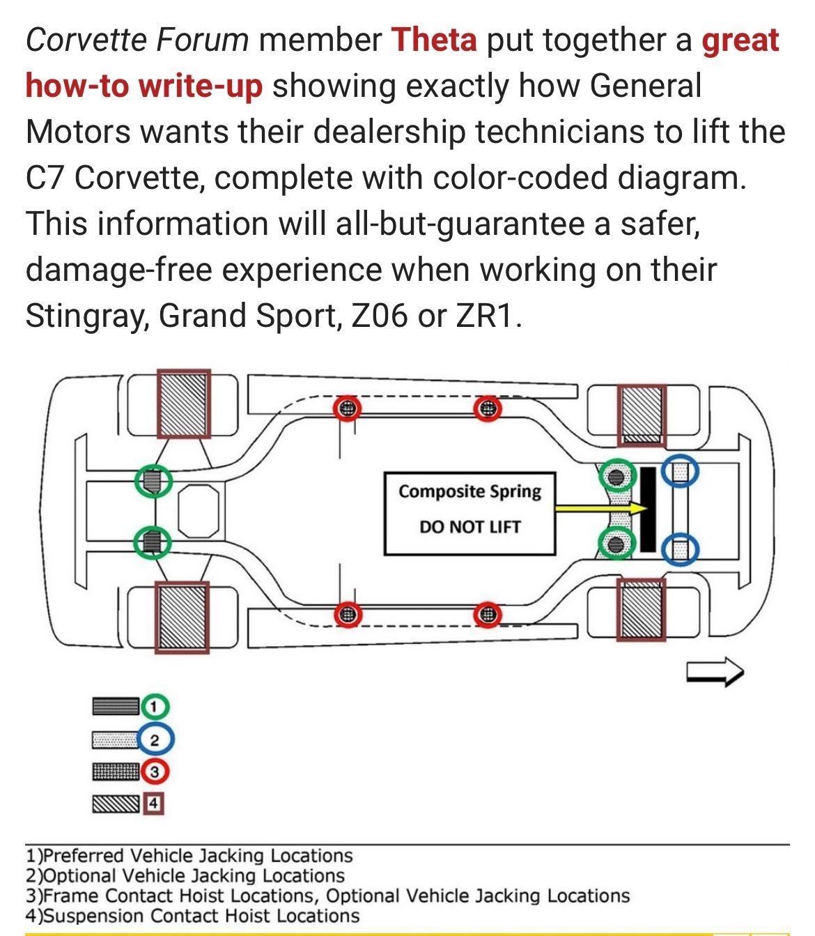

Looking to pick up a low profile jack & pucks so i can do my own own oil changes and brake pads etc, looks like the ride height front to rear is 3“ & 5”, harbor freight has nothing under 3-1/4 that i can see, so just looking for some recommendations, thanks 👍

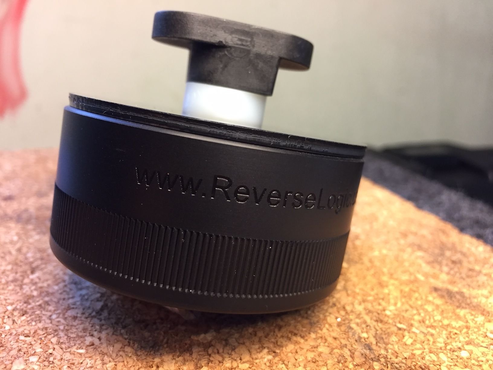

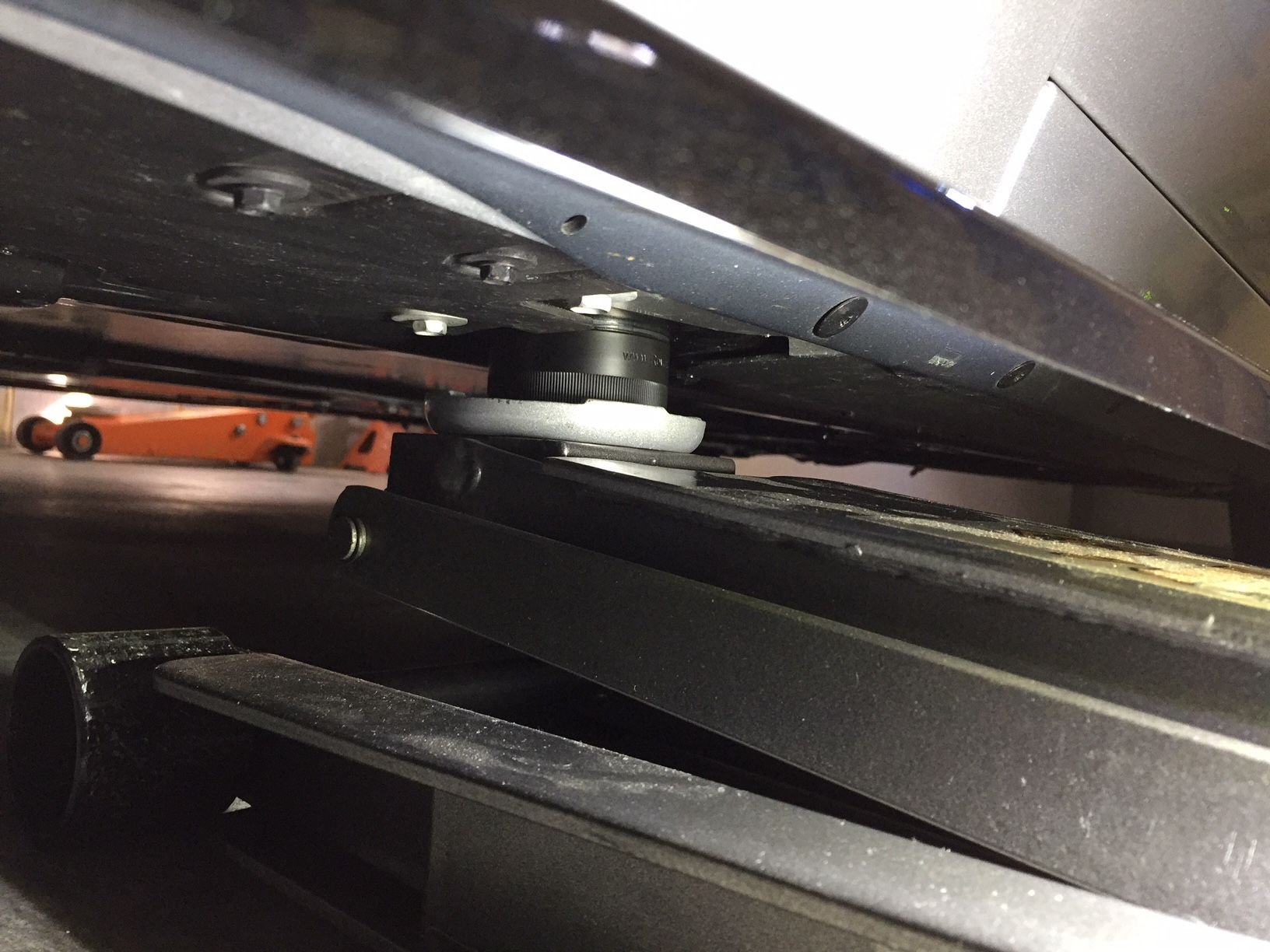

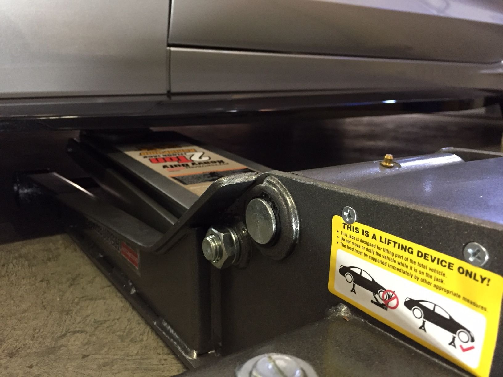

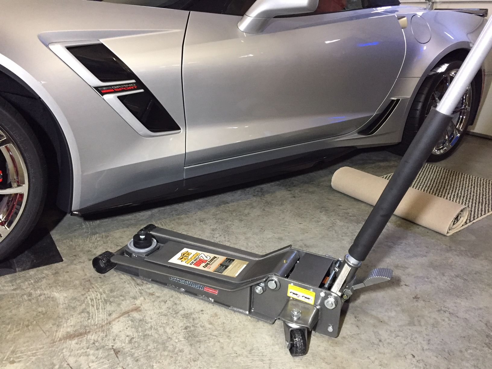

The below is Harbor Freight low profile jack and pucks I've used successfully for years. The foot pedal is great for tight areas where you don't have space for handle travel. Some people like the 'leave-in' pucks, however I know two vette owners who have had them fly out and damage rocker panels, so not for me.
Keep mine in the trunk cubby and only takes about a minute to install one.

I was going off this diagram for
the front and rear points, actually the side spots with pucks should suffice for what i need, need to measure and check harbor freight again lol

I have this jack. It works great. Always use jack stands.

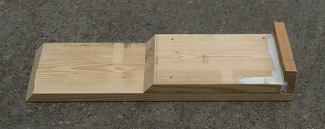

Also, you might consider making some ramps. I made two of these with 2x12" boards for minimal cost and added another layer after this photo was taken for more height. What you see is assembled with screws and glue, but the third level is quickly removable using pins. With the extra level you have enough space to change the oil, etc., that is if you aren't circumferentially challenged.
