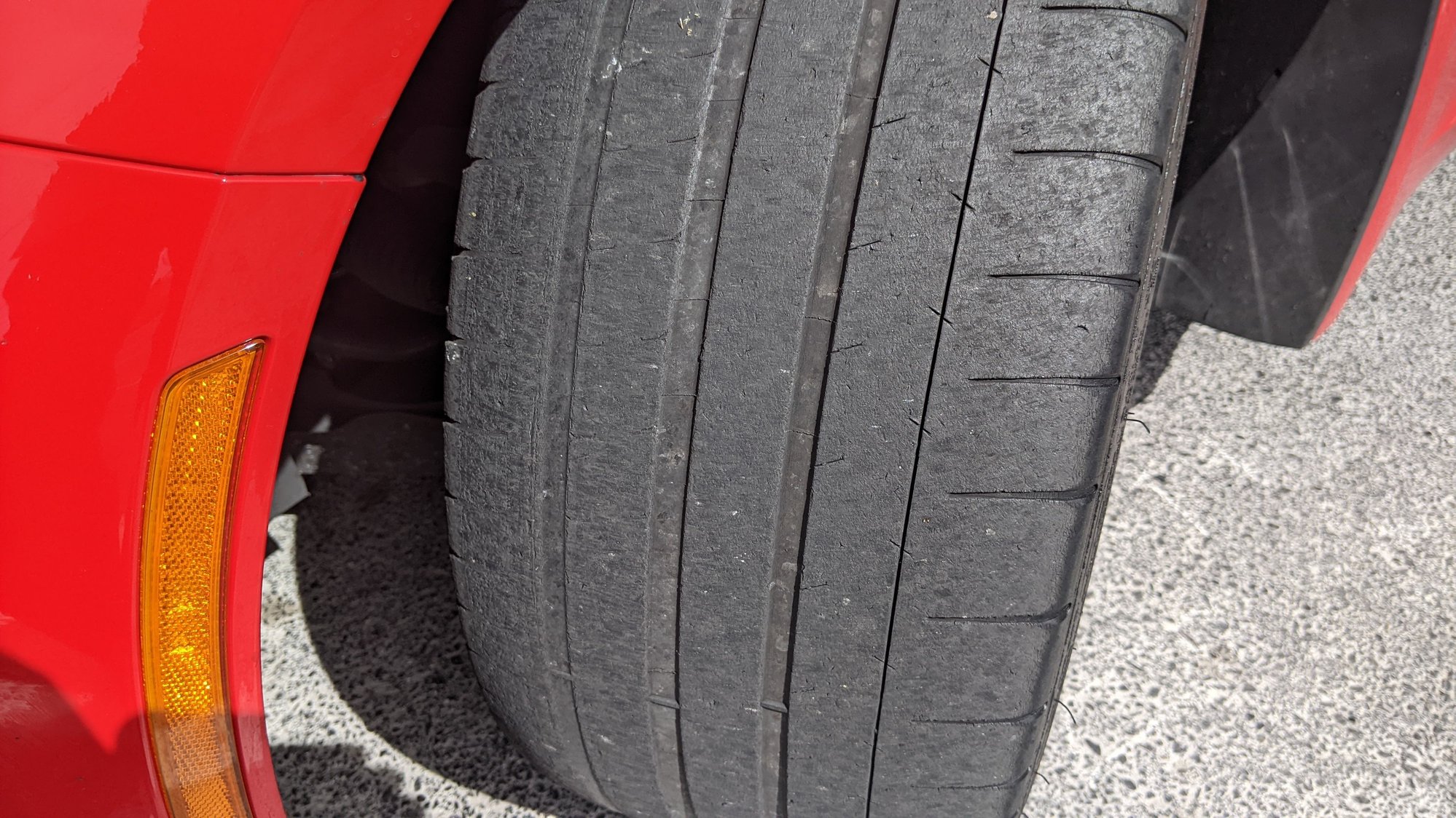

Although not anywhere near as bad, my fronts wore that way as well. That alignment spec gives you a great on-center feel, but that wear pattern is the cost. I have an appointment tomorrow to get my alignment as I just got new tires this past week. Here is my old front tire:

Yep, negative camber ruins more tires. I have said this in a few threads. If you drive somewhat aggressively, 1-1.5 deg negative camber will work for you. Basically your cornering is wearing out the outer and center of the tire while the camber wears the inside when you are driving straight. The tires wear faster overall, but they wear reasonably evenly. If you are a calm street driver, go for 1/2deg negative.
how many miles?
Old Jun 27, 2022 | 08:44 PM
VistaVette's Avatar
VistaVette
Joined: Mar 2005
Posts: 638
Likes: 192
From: Las Vegas NV
Originally Posted by need-for-speed
how many miles?
Ummm....I'm guessing 25k-30k. I had to replace a couple of tires due to damage and I don't remember exactly when. The car only has 36k on it
