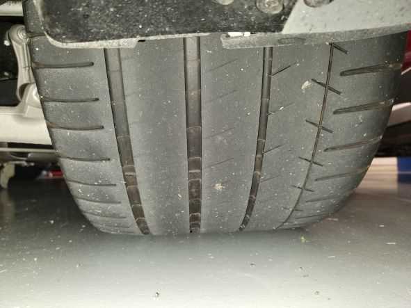

No.... definitely not hard on the tires. And I may have mislead.... not bald all the way across, mostly just those wide, center strips of tread.
Maybe I'm jumping the gun here. Now that I checked my neighbors C7 GS, they may not be that worn down after all.
Here's a pic. Any help?

Looks like a lot of tire life to me.

You know I never realized what these tires looked like when new, so I was kinda dumb-struck after coming home from a 2500 mile road trip this week.
Maybe I'm good for a while?

You can buy a tread depth indicator tool. That will tell you how much tread life you still have. These tires only come with 9/32.. I run my tires untill about 4/32 left.

The new tread depths on the Super Sports are 7.4/32“ on the fronts, and 7.8/32“ on the rear.
Mine have 9,500 miles on them with a tread depth of 6/32". Most people get at least 15,000 miles out of them. But many replace them when the they get too noisy.

I measured my 2017 GS when new and the depth was 7.2, 7.2, and 6.7 (outer, middle, and inner grooves) on both front and rear. Note the difference in the inner groove. I also checked a new GS at a local dealer with the same results. OTOH, my 2015 with Z51 tires showed 8.5 front, 9.0 rear--but I did not compare the different grooves on that car.
My GS is now at 4/32 front, 5/32 rear on the inner groove at 11k miles, so I think these tires are wearing as expected. I noticed more wear on the inner front at 7500 miles and had a street alignment done, which seems to have corrected the problem. Toe and negative camber were not set for optimal tire wear from the factory, which I understand is typical.

Looks like there is plenty of tread left on that tire, but confirm with a tread depth gauge. When the time comes for new tires, I would suggest Michelin A/S4+ tires. Personally I would go with the ZP runflats, but the would be your decision to make.

Tires look great. They have less tread depth when new so compared to other OEM tires can appear worn. Wife’s SUV is a Dodge Durango SRT and they look the same. And actually more expensive to replace.

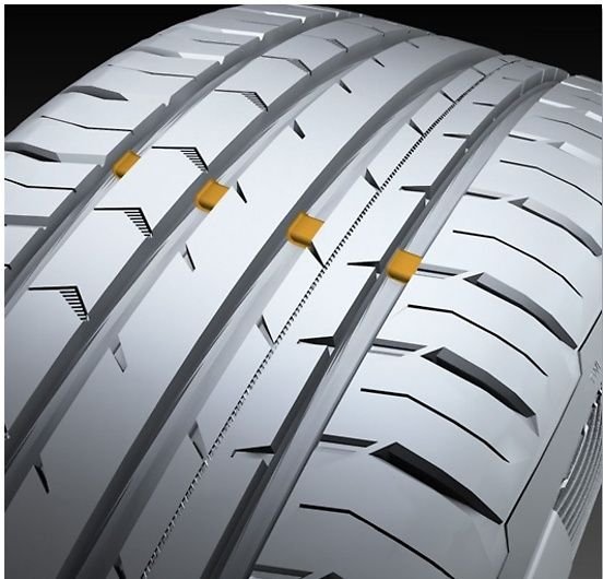

Looks like I have some time left after all. I did the depth measurement and I am getting about 5/32 to 6/32.
Might get another year or two out of these tires seeing I only put on about 3,000 miles per year. Are the wear bars those diagonal lines along the right side?

Wear bars:
