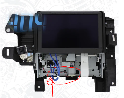

mine is the same year model, and what happened on mine is from lowering and raising the screen there are 2 blue wires that rub and break connection. it was about $1100 to replace it at the dealership. the revised screen had a loop on it to keep the wires from wearing. could you do it yourself, possibly, but you have to rip alot of the dash off. i could reach up under the left side of the dash, jiggle the wires and it would come on for a second. this is the revised part

here is the revised part
and this is why i didnt do it myself

I might have the same loose wire condition you had. I've just noticed that even though the screen is black, it will occasionally 'flash' the screen icons for a brief split-second when being lowered, before it returns to all black again.
