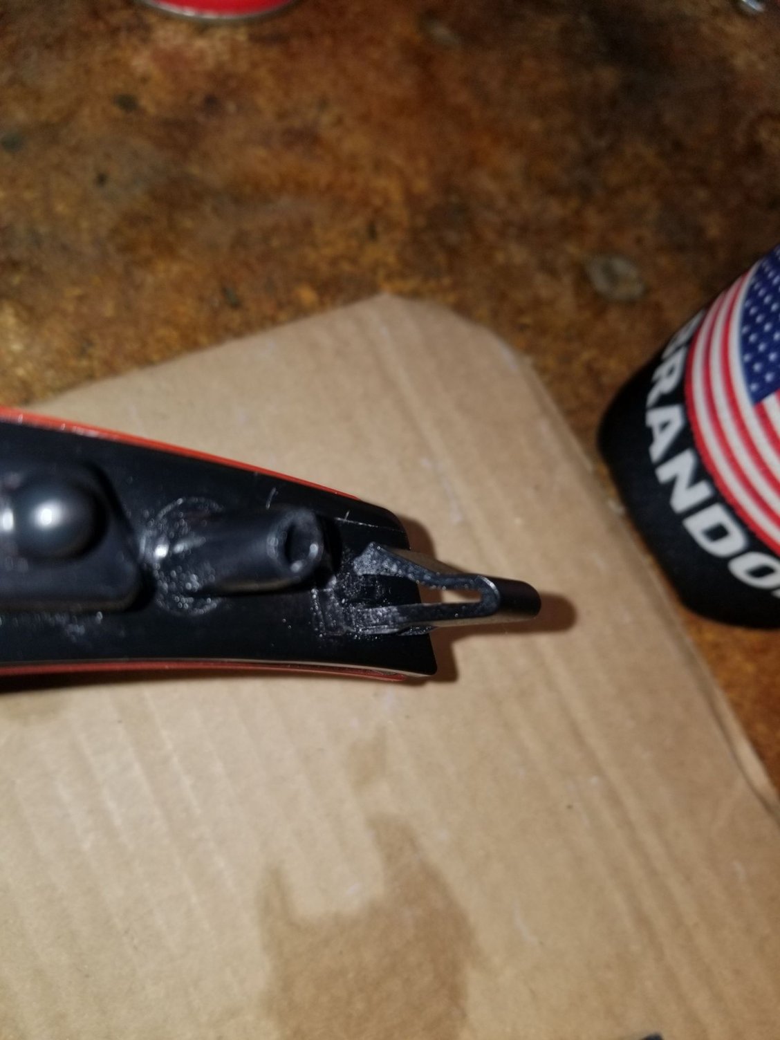

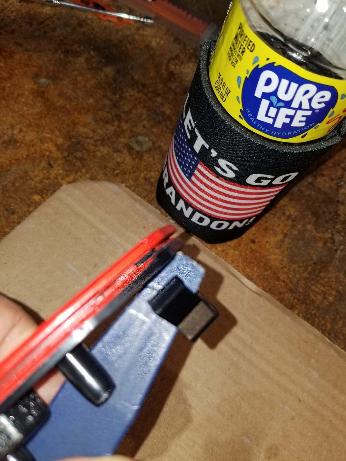

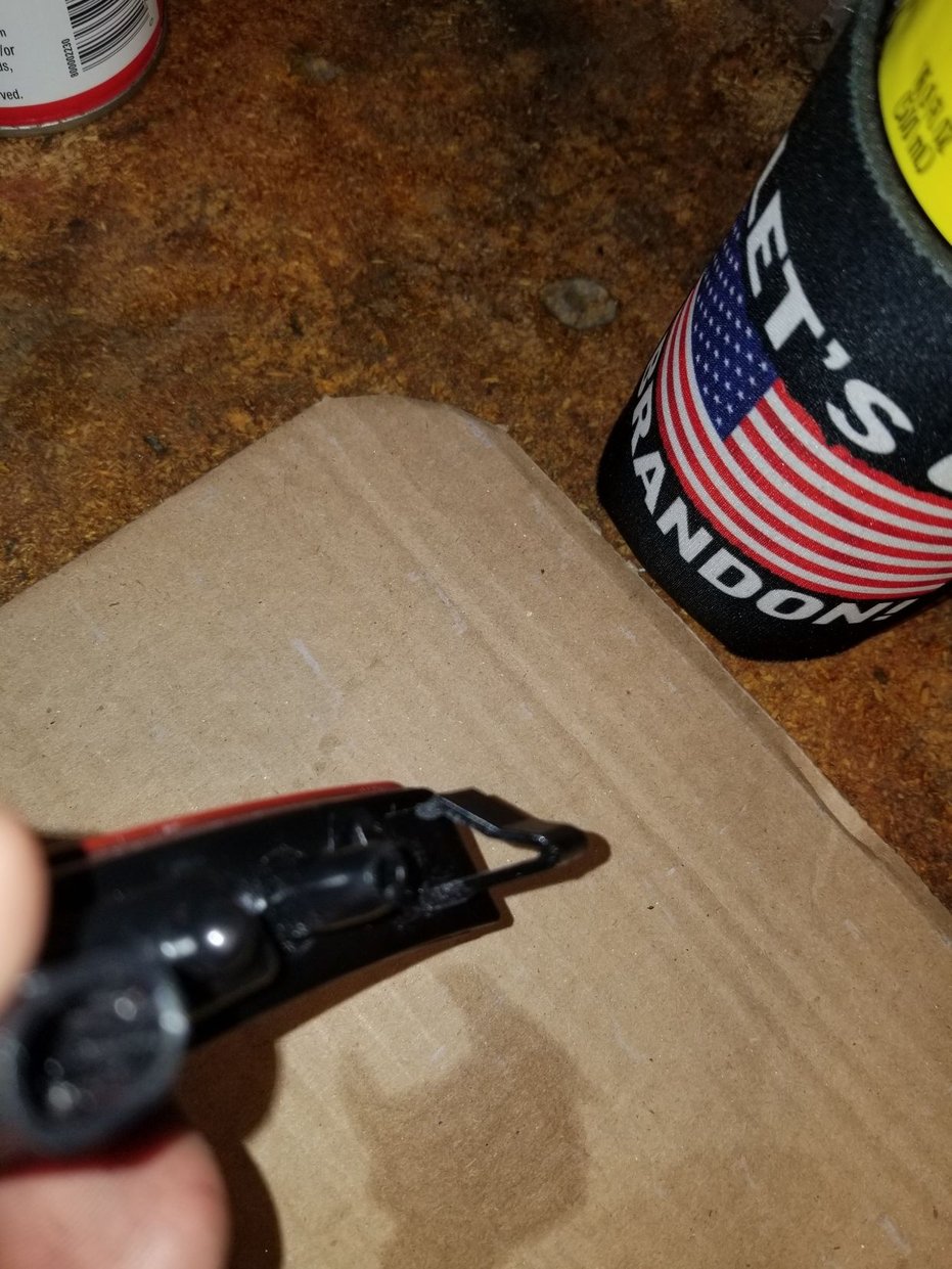

A few points on install. The first I did was Driver’s rear. That is the one that has the most fitment problems as I found out. I had it in and out a dozen times to figure a solution. They recommend pulling on the tab spreading it out further. That is impossible on the front on a Z06 with stage 3... you have almost no opening to work with unless EVERYTHING comes off (I am not un-taping the painted spats) The solution that was easy and made sense was to use a plastic pry tool to gently push tab out. Once you have mild pressure on it just hit it with a focused adapter on a heat gun (You could use a lighter as well) Just make sure tab is out further before you reassemble. Mine snapped in with authority on all the markers after spreading.
Tab before spreading
Pry bar spreading
Tab after spreading and applying a little heat

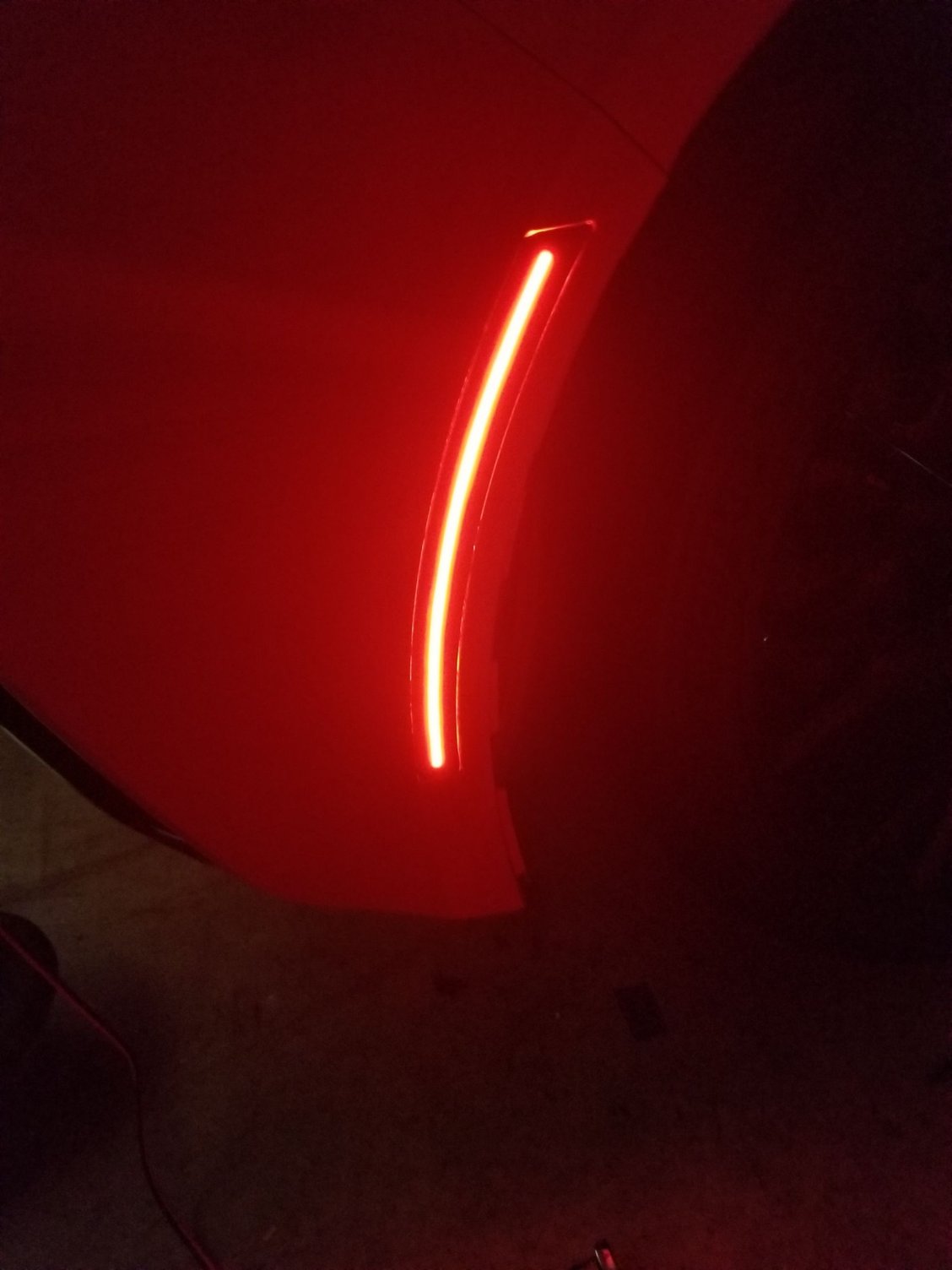

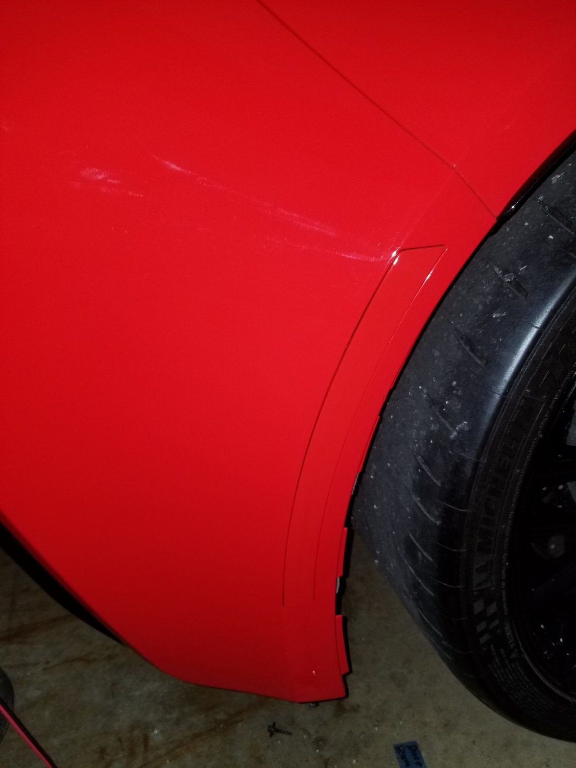

A few pics installed. I will add a pic outside when go for a drive today. I think they look great. Anyone who needs more info just PM me...
Rear Off
Rear On
Front Off
Front On

Nice and also like your can holder.

Exact set I have on my car! Looks great, right?
I love the way they blend in with the car to disappear until they are turned on.

They disappear nicely.

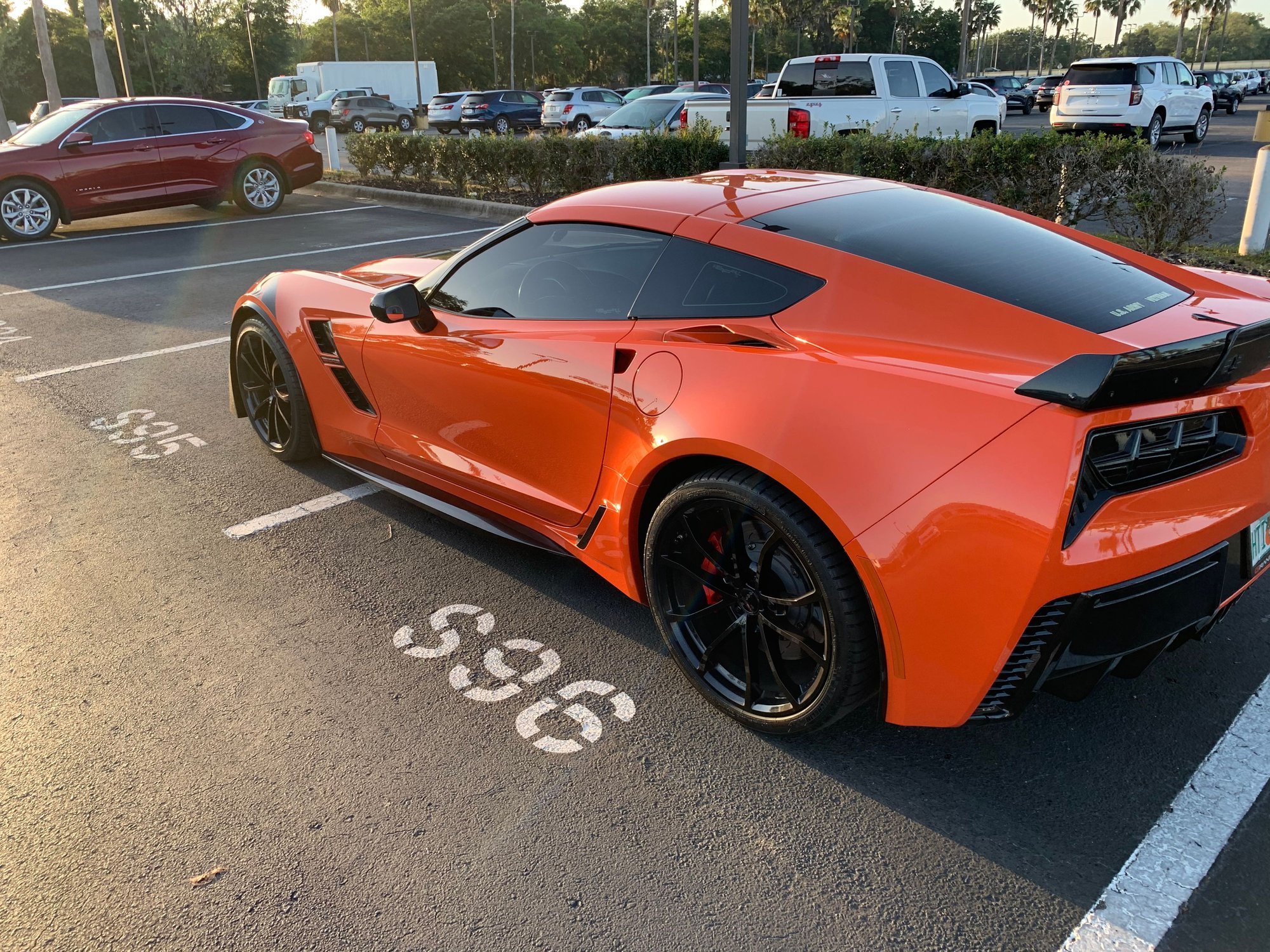

I’ve got mine ghosted in shadow grey and love it

Went with dark smoke figured they blend quite nicely

I got mine direct from them, just watch for sales... Those look great on the Grey.. they disappear!
