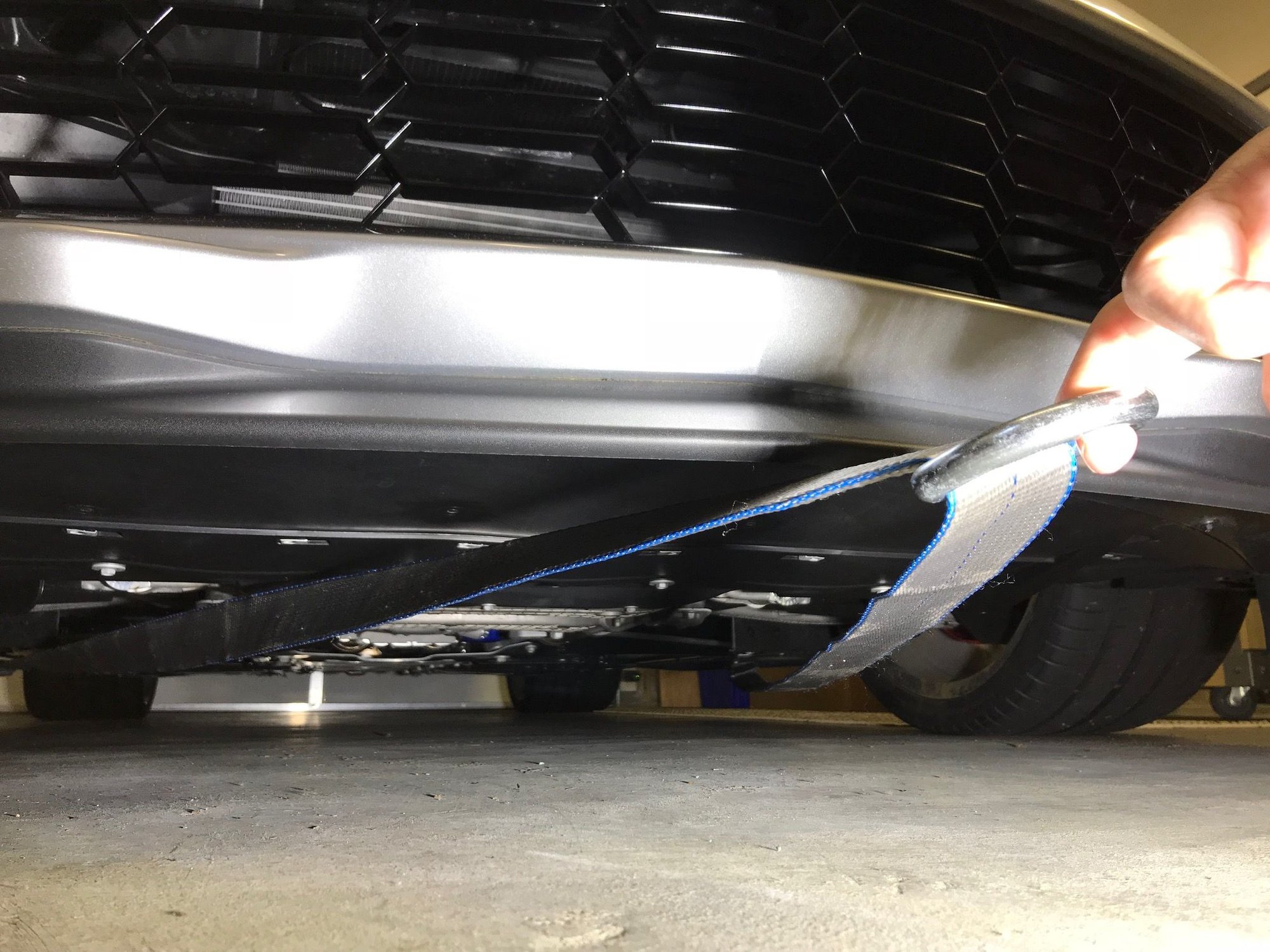

In my opinion, if you don't track your car, you won't need them as they're required equipment for track towing in case. Save your money as they'll cost you over $100 for the pair. Lots of people install them strictly for looks-sort of the same as the Mopar owners who leave the front yellow spoiler protectors on-strictly for looks. You'd be better off investing a in a long under car tow strap with the hooks that install into the holes under the frame where you insert the lifting pucks. If you really must have a set of tow hooks, I have a pair that I bought and never used-still in the original boxes that I'm willing to sell you. I took my own advice and purchased the tow strap instead.

The strap noted above. I have one in the car. Thankfully, never used.
https://www.ebay.com/itm/30274267284...kAAOSwrWVbIuEg
Sidenote: I did have to use the one that GM put in my Camaro ZL1. Sidewall puncture that necessitated a flatbed tow. Made it easy for the wrecker driver. I'd guess a tow hook on the Corvette would work as well.

The EBay strap. The hooks go where the jacking pucks normally go ???

Correct

The tow hooks are only to be used if you plan on tracking your Z51 IMO. I take mine off before I leave the track.
Most flatbed drivers have some chains or straps in their box that use the mounting holes in the frame rails, Though most will try to just drop a steel hook onto your lower control arms to save time. You need to be there to stop them from doing that.
If you are truly concerned about incidental damage to your car by all means get yourself a proper strap and keep it in the back.
