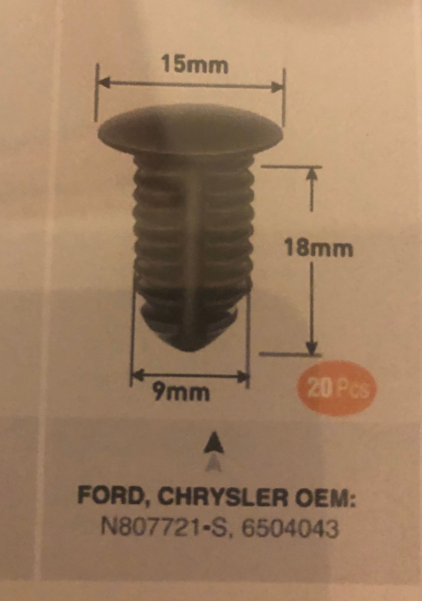

After trying several I found these to be perfect:
Insert in hole on door, done. No need for fuel door locking, most vehicles don’t.

If you install this I gues the pin from the aculator slams against this rivit everytime you open and close your entry door. What happens to the mechanism, does it stay powered on and do we drain power? Does it just momenttary have power to move the pin and then powers is removed? Just wondering about what it will do to the mechanism as it keeps slamming into the rivit. One thing though, you won't have to worry about a stuck gas cover.

It is a momentary stab of the plunger to lock the door. It will not hurt anything and it will not drain the battery. I plugged in a scrivet and don't worry about the problem. There is a device in the neck of the fuel pipe that stops hoses from going down in the tank to siphon the gas out.
Don't worry about people stealing the $50 a gallon gas. Plug the hole with a scrivet and forget about the stuck door problem forever.
