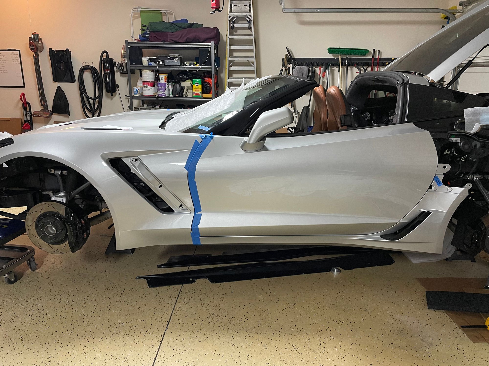

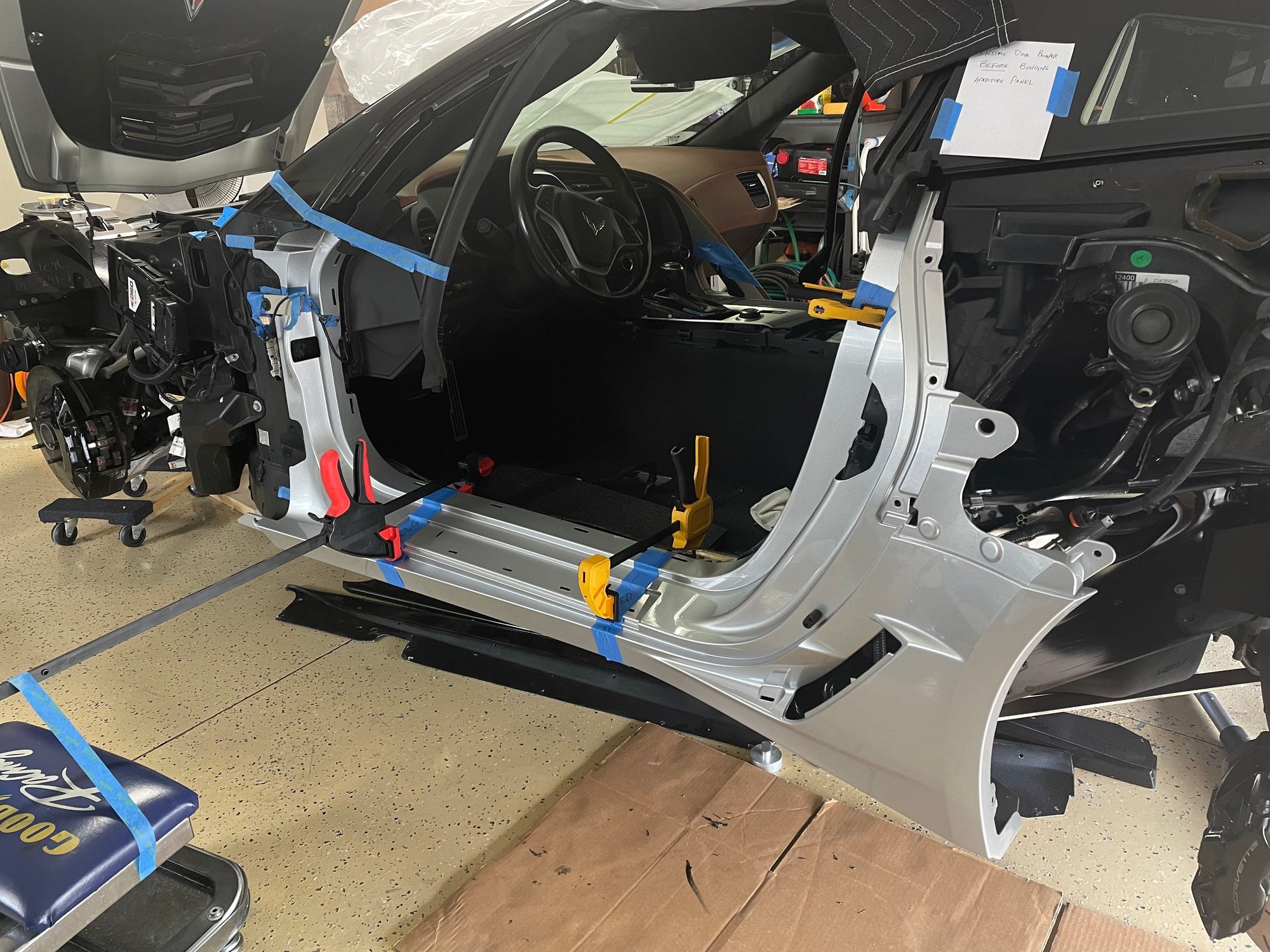

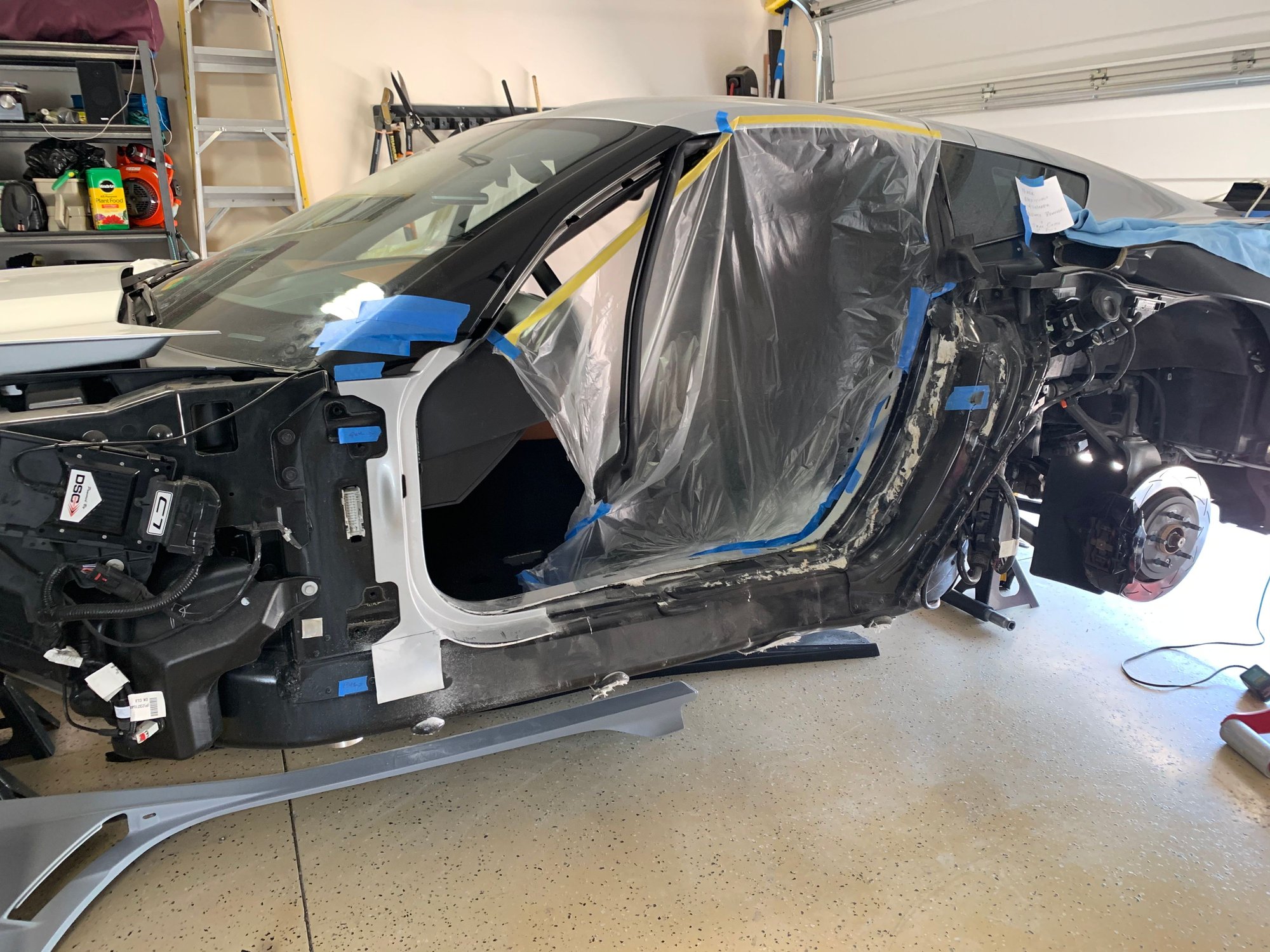

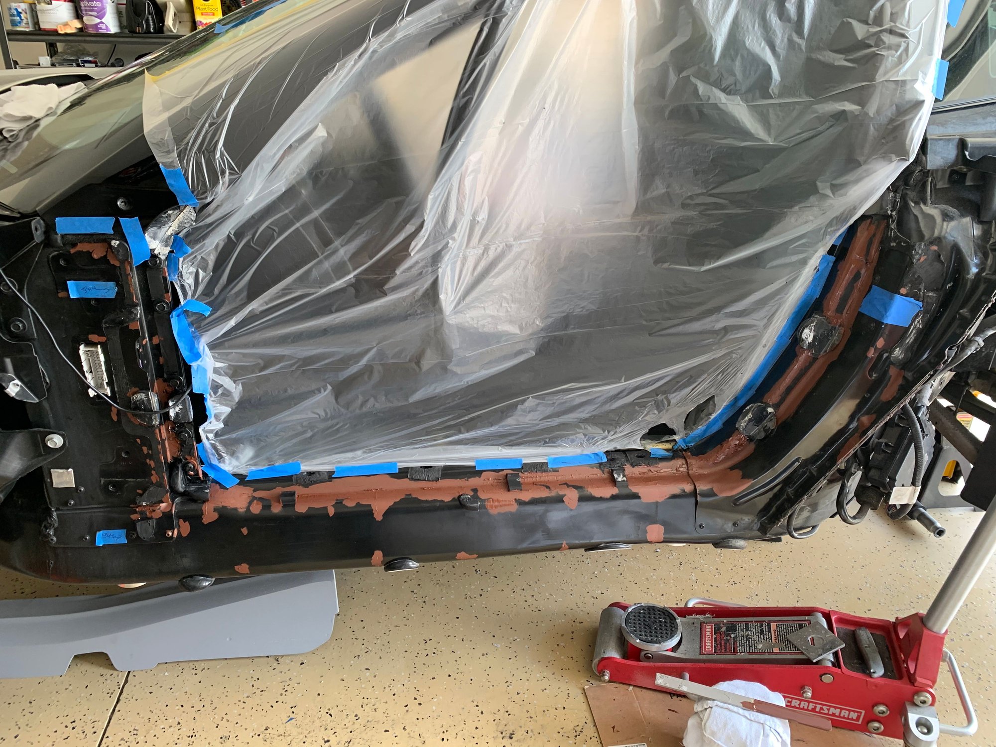

In order to make the fenders and quarter panels fit, you’ll have to rip the apertures (rockers) off and replace them with the OE widebody version. It quite an ordeal. I used a combination of cutting wheel, multipurpose oscillating tool and a heat gun to remove the old one.

Wow that's exactly what I was looking for. Seems like a lengthy process but it's doable. Is your car finished ? Thanks again now I'm more motivated to do this 😊
Yes. It’s finished. I’d be happy help where I can.
