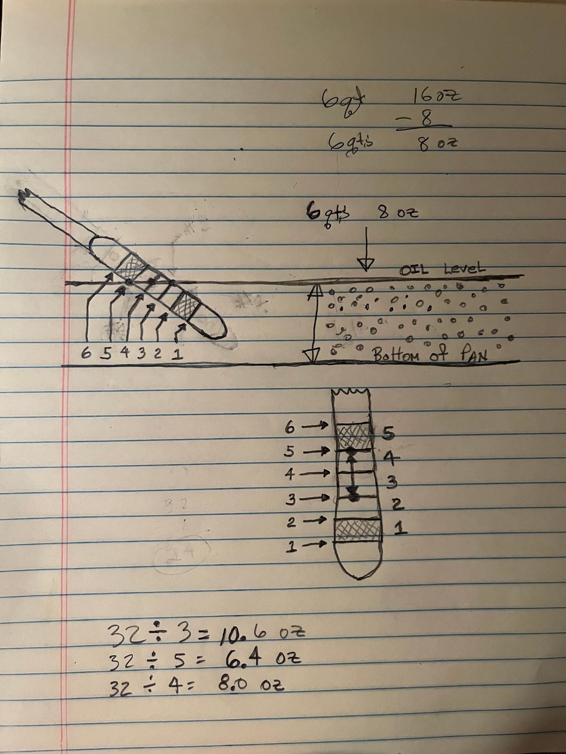

Old Aug 29, 2022 | 09:55 PM
Tinkertech's Avatar
Tinkertech
Joined: Feb 2018
Posts: 2,199
Likes: 1,057
From: North Texas
This is the data that I have so far
#3 low reading
#5 high reading
