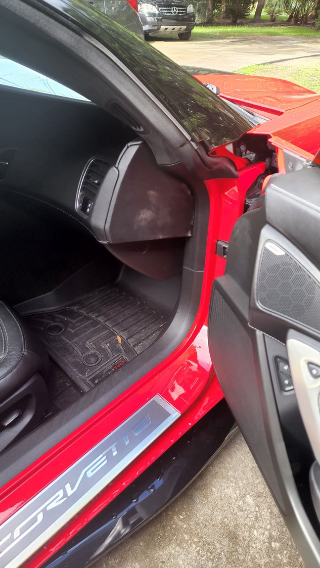

Thanx for all the replies. I re-indexed the pass. window this morning, so waiting to see if that helps. There was moisture in the area this morning, and I did not drive the car yesterday. So it's looking like a rain issue and not an A/C issue. The image below shows the area. The mildew wipes right off. The 2 or 3 inches below the pillar vent feels a little damp, so I'm just wondering if the moisture is coming in higher up (by the soft top/windshield junction) and finding its way down? I'll know more after the window re-index testing. Thank you all!!

…just checking…you realize that just wiping off mold and mildew doesn’t kill it right (it comes right back). You need to clean the area with something that will kill it which is why I suggested the Clorox wipes originally. Good luck.

Thank you for the clorox wipe suggestions - will do. I need to do a little more testing, but I did find a youtube video with someone who has a very similar problem to mine caused by a small hole in the windshield gasket, all the way up by the top.
Does anyone know if this gasket (says coupe) will work for the 2016 convertible also?
Windshield Frame Weatherstrip - GM (84367842)
