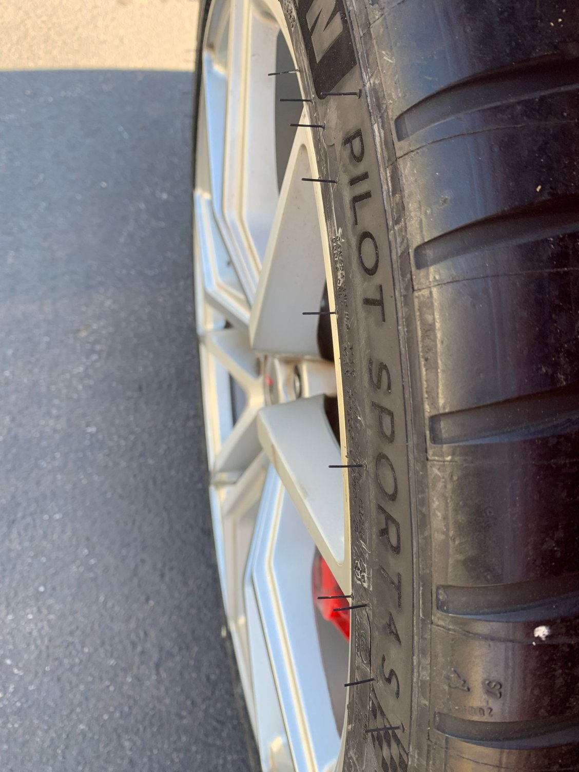

Well the new tires are getting put on at 2pm today, they are Michelin Sport 4S in sizes 267/35zr19 and 305/30zr20. Couple questions: First, the Michelin Sport 4S - can you really not drive these below 40 degrees? I don't see it happening often, but if I want to go to a cars and coffee event - it could very well be in the 30's (but sunny) when i leave. Second question, the Conti Extreme Contact Sports in 245/35-19 and 285/30-20 are in great condition, is there a market on here to sell or should i try local to avoid shipping cost. Thanks

New tires on and fill the wheel much better and didn't require any additional adjustments. Once i clean them up will take a nice pic to post.
