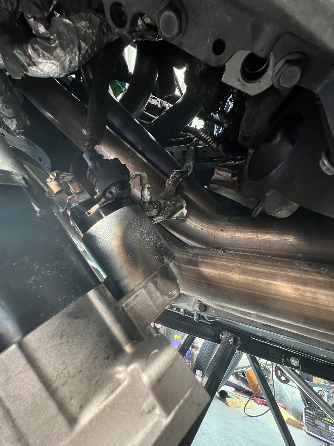

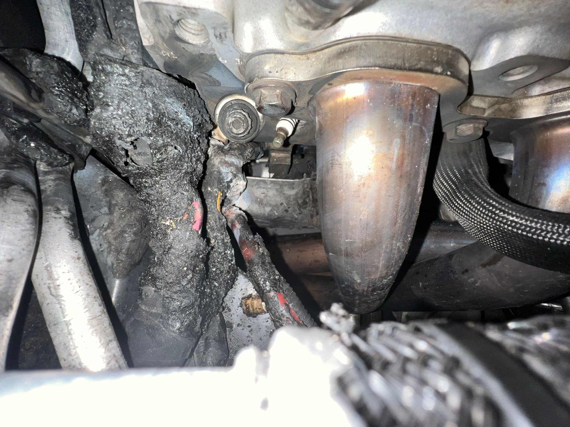

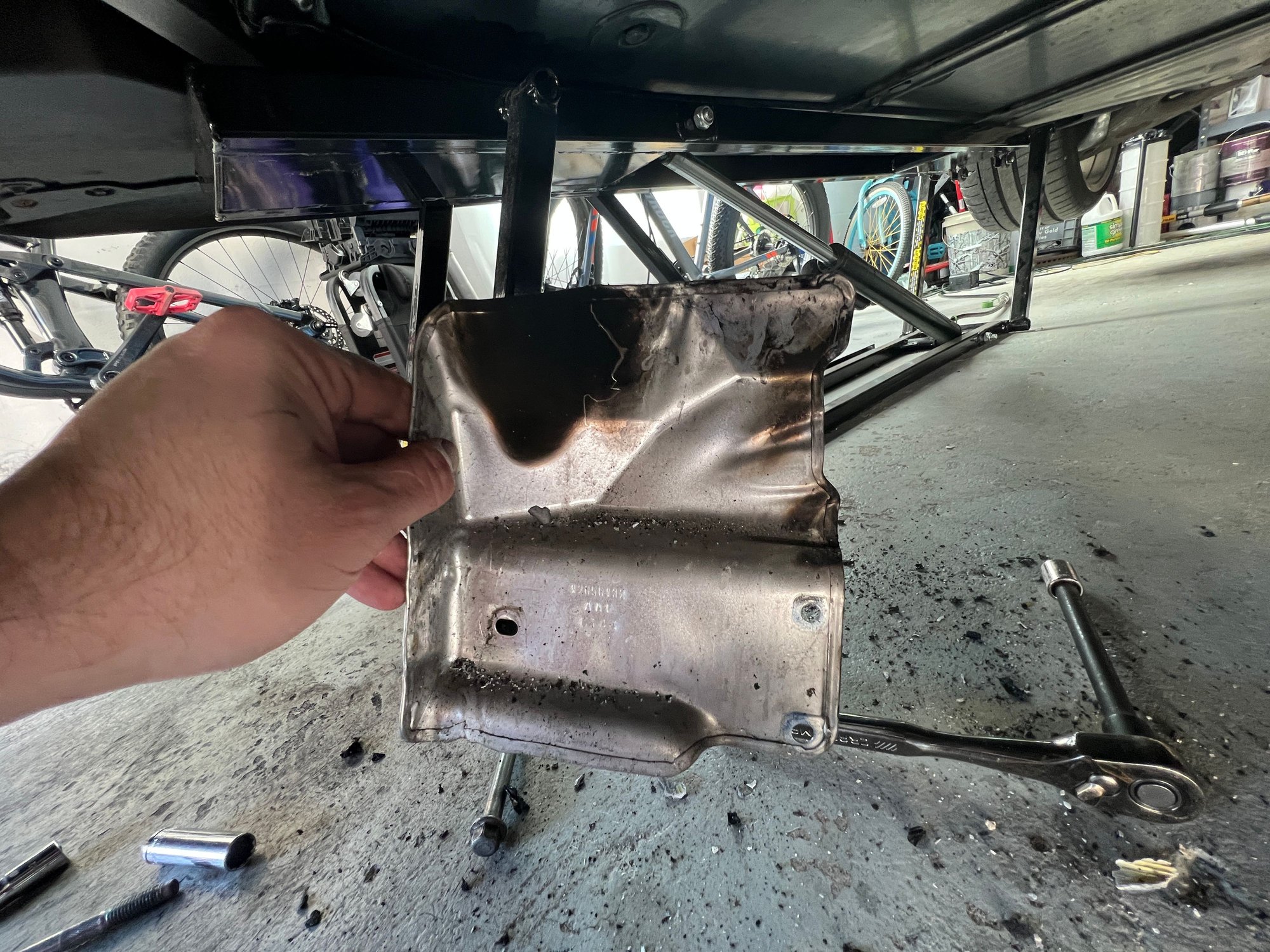

I replaced my starter this weekend, made sure to re-install the heat shield. Everything appeared to go back to where it was before removing old starter. Sunday I'm cruising around and release I'm starting to over heat. I pull off and see no water in the reservoir and then see a small hole in it. I let the car cool re-filled with water and made the 5 min drive home carefully watching temp gauge. After inspection I see there was a small fire coming from the starter area. I don't see any wires near the headers so part of me is wondering if the solenoid stayed engaged and overheated to the point of fire. Luckily my coolant reservoir put the fire out. I could only find one other similar post. Just curious if anyone else has experienced this??? The starter was AC Delco.

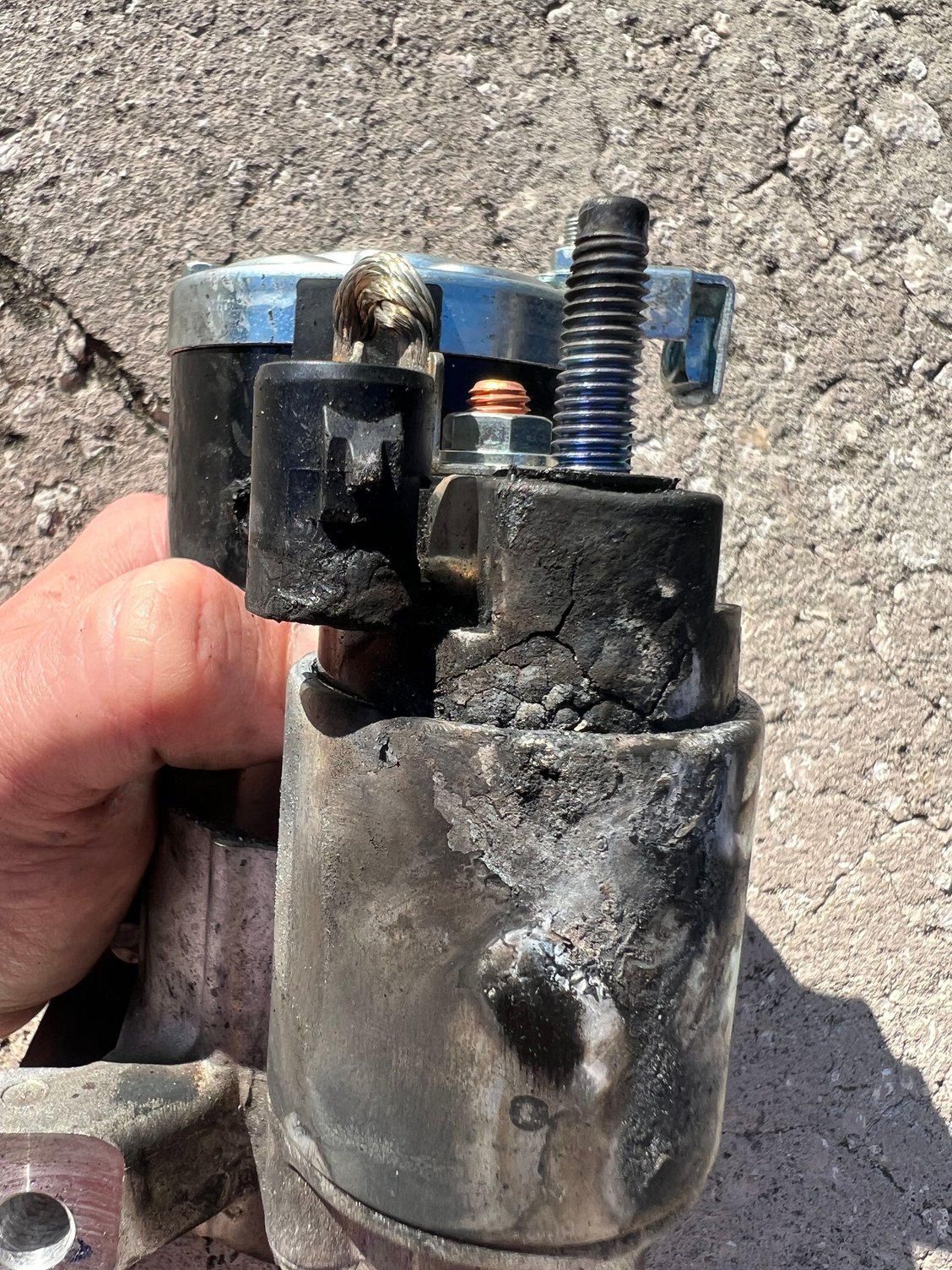

the starter works but the clip on wire looks cooked.

Looks to me like the solenoid overheated.

It was a new AC Delco starter that comes with a new solenoid attached.

It appears that the starter gear became hung up on the flywheel and continued to run, overheated and caught fire. Although it was a new AC Delco starter you may need one starter shim to allow the starter gear to move away from the flywheel just enough to allow the starter to disengage when you release the start button. When you install the new one you can have someone listen to the starter to see if it disengages. If you do have to use a shim start out with the thinest one you can so you don't move the starter too far away from the flywheel. Over the years I have had to shim a number of starters.
