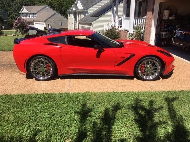

I have 9" front and 11" wide rear wheels with the stock Z51 tires on my 2016 Z51.
Don't look too bad.
