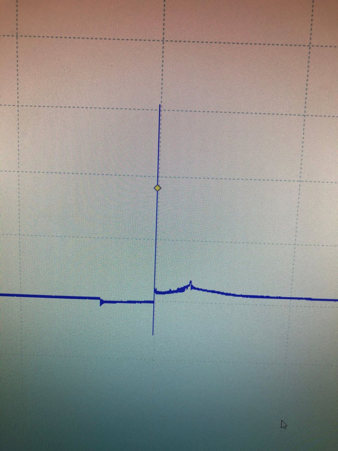

Unless they look at secondary ignition using a scope they can’t verify that plugs and wires are bad…and I know they don’t use one…I’d tell them if they change the plugs and wires and it doesn’t fix it then you won’t pay for the repair…let them put your old plugs and wires back on and you move on to someone who can diagnose it correctly…dealerships don’t diagnose…they only replace parts !!..below is the secondary ignition waveform on my car…I can tell if the plugs, wires, or a coil is bad by interpreting this waveform.
