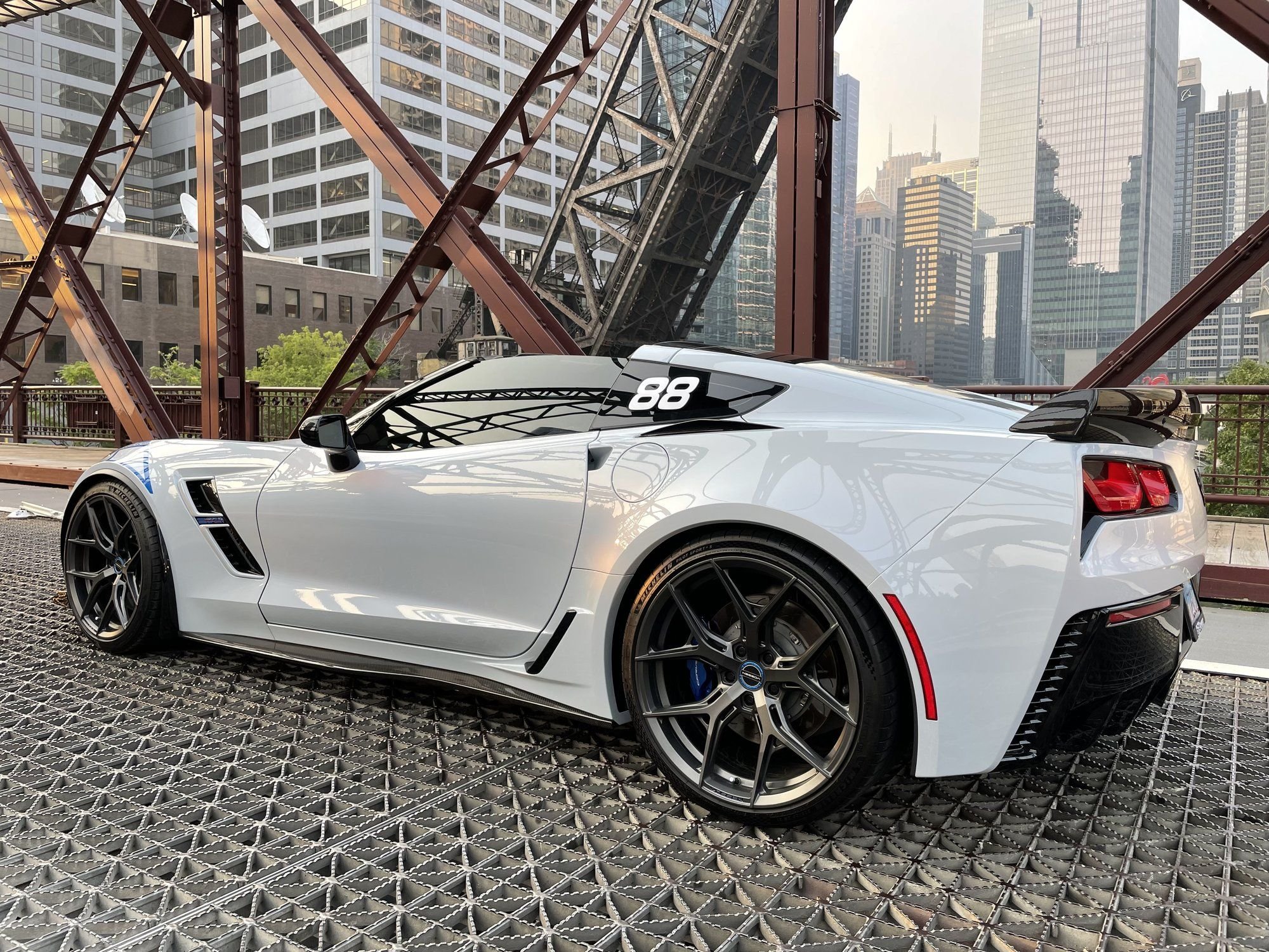

Not my car but it looks awesome. He said he has no problems with the computer or the speedometer acting up. These are the size tires he has on them 285 30 R20 325 25 R21. There Vossen HF5 wheels.

What color are those wheels?

Either matt gunmetal or anthracite I'm not sure.

It doesn't look like there is much rubber between the road and the rims ! Just sayin', It does look good though !!

That should be anthracite

That looks fantastic!

The wheels on that white GS do look very good, but as another member stated, those are very small sidewalls, especially on the back.

It does look like a very short sidewall, but the spec provided says 325/25/21 and given the sidewall specification is an aspect ratio of the width the sidewall should actually be just a tiny bit shorter than the standard 335/25/21 (81.25mm vs 83.75mm) on the GS/Zs, right? Of course it could be the tires too... There isn't a 335/25/21 available at TireRack but there is a 345/25/21 - might be a better alternative. I'd expect the 345 would still look good on a 12" rim...

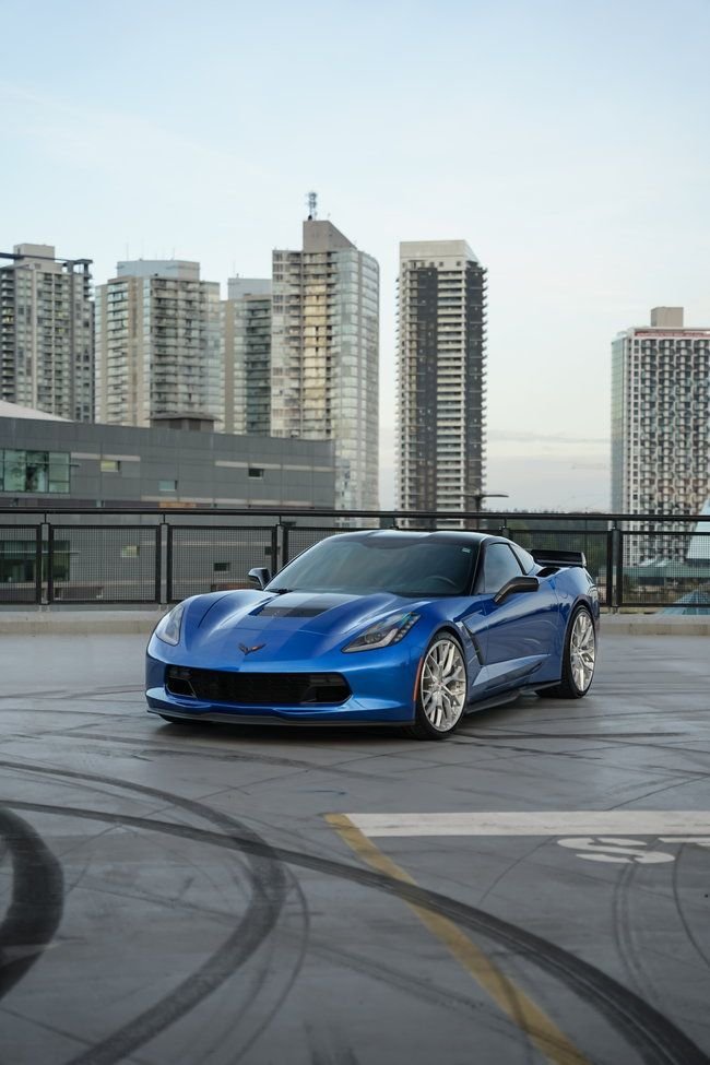

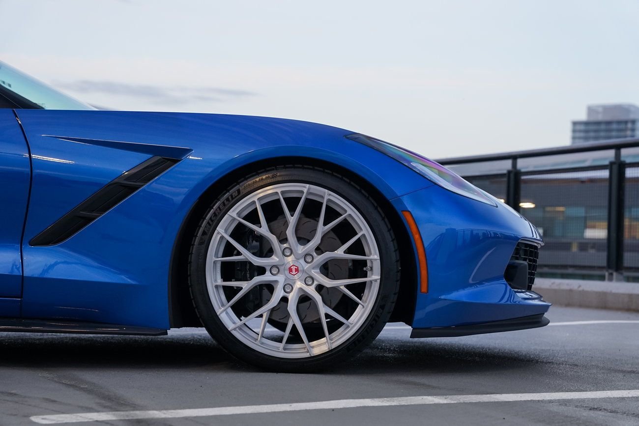

Here is my 2014 Stingray 3LT Z51 and the wheels are 20x9.5 in the Fronts with 275-30-20 and the rears are 21x12 with 323-25-21 and it has been lowered on stock bolts

Very nice!

I just bout some rims with this same dimensions. Do you know what offset the rears are? Tire shops are recommending a323 but I have 305’s and they rub on stock z51 rims.

I just bout some rims with this same dimensions. Do you know what offset the rears are? Tire shops are recommending a323 but I have 305’s and they rub on stock z51 rims. Do your rub and should I stick with a 305 or go 295?
