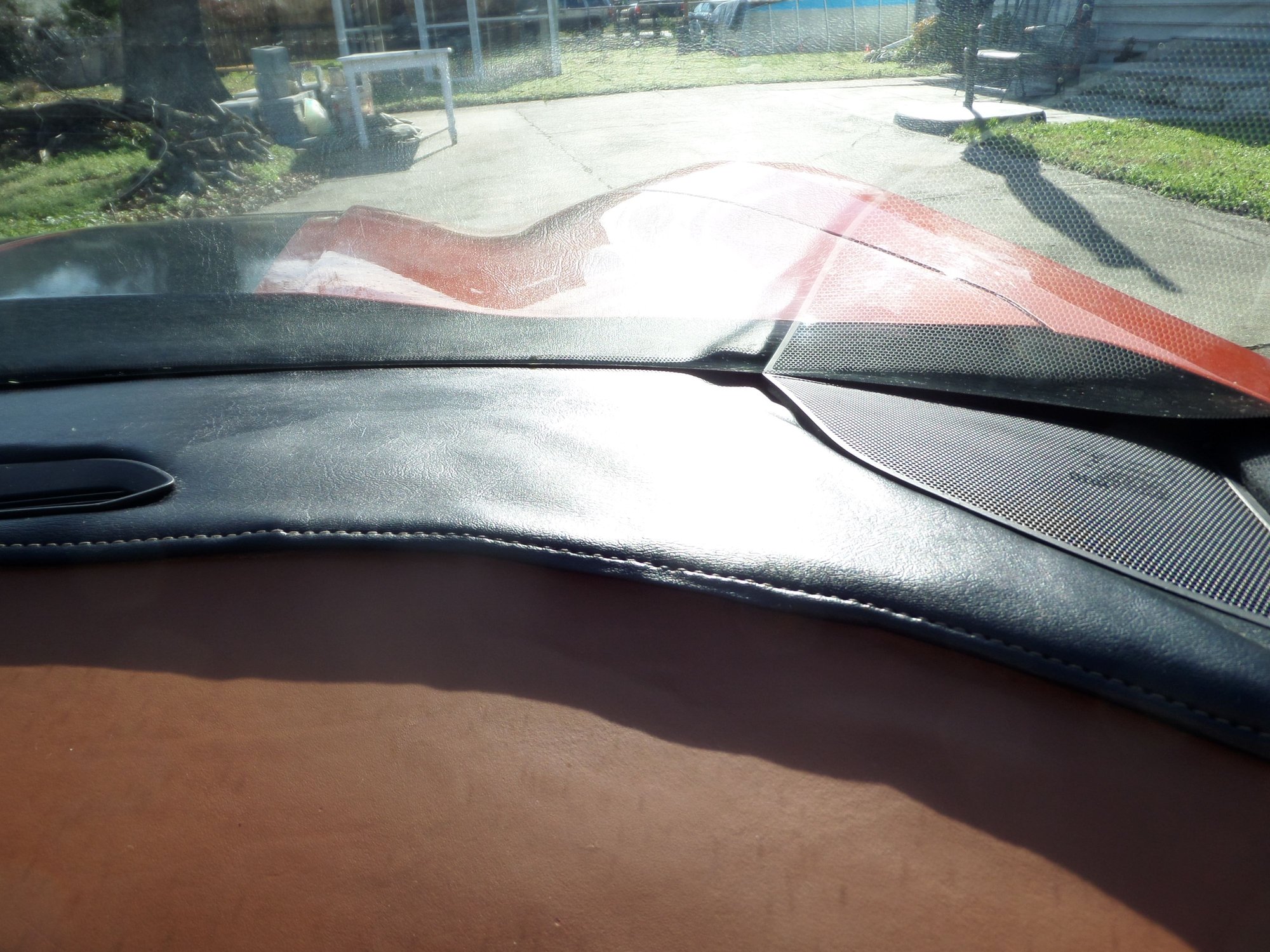

I had the problem on my 3LT 2015. Had estimnates from $3k to 6k. I found an upholstery shop here in Hampton VA. I spoke with the owner he said he would replace the leather with a marine vinyl. Its very high quality. Now to be honest the vimyl looks very nice but it doesnt fit as well as the oem but I only paid $450.00 for the work. The dash looks 100% better than it did before with the GM junk leather all shriveled up and pulling away. Looking at it from the outside you wouldnt know its not leather. The picture I have doesnt do it justice it has smoothed out as its been on the dash. For the cost saving for now it works for me
Glad it worked for you, how big was deal to remove the damn dash?
Ken
Ken, actually he did the work without removing the dash. He is almost 80 y/o . I was lucky to find him as he is about to retire
