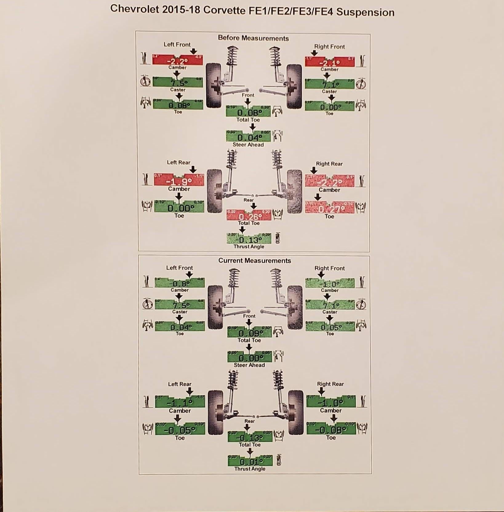

These are the specs I got from DSC Sport - it definitely helped my Z06 be a lot more predictable under moderate to hard throttle.

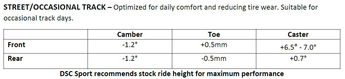

That appears to be dated info. DSC currently lists the following alignment specs on their site:

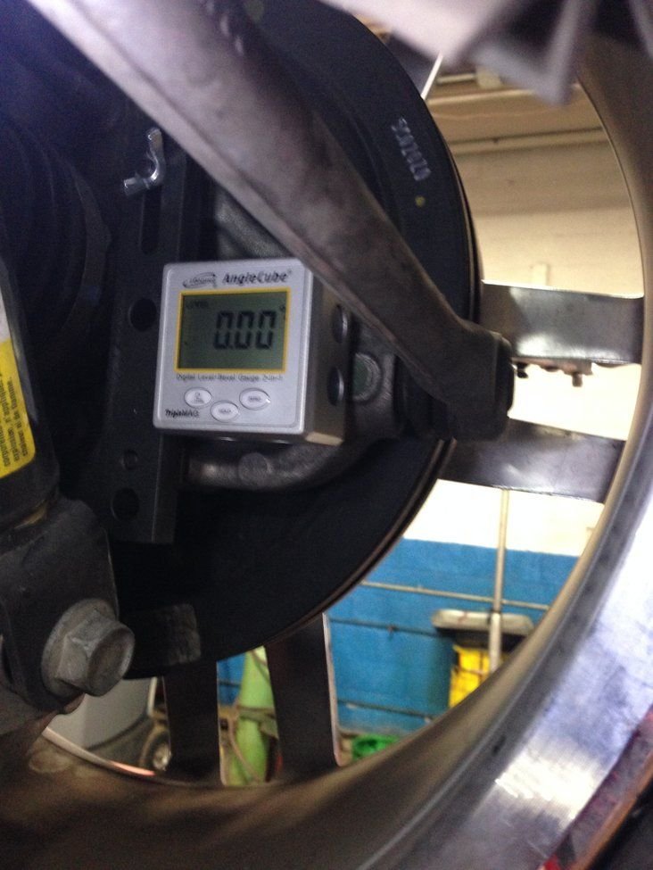

Alignment machines Cannot Measure or Display Rear Caster. If Camber is Adjusted Rear Caster will change. You have to Adjusted together.
There is a tradeoff between cornering grip and tire wear.
I do several autocross weekends each season and sometimes a day at the high speed track. All of those tend to wear the outside edge of the tires more than the inside edge.
On the two C6's (44k and 102k miles) and C7 (now at 52k miles), I ran about 0.7 degrees negative camber front & rear, 0 toe.
That camber setting still tends to wear the inner edges of my tires even with my harder driving trying to wear the outer edges. It's not a huge amount, but I could definitely get maybe 20% longer tire life with less negative camber.
I think the DSC settings for Street/Occasional Track have more negative camber then most people will like.
