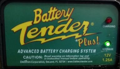

Do Not use a trickle charger. You need to get a Battery Tender. I started using Deltran Battery Tenders back in 1987 with my first C4 Corvette and have batteries last 10 years. My 2016 C7 is 7 now 7 years old and the battery is still good.

Is a corvette battery charger different from your tender. I just picked up a OPTIMA AGM. I read it was fine to use the vette trickle charger . What is your option based on ?

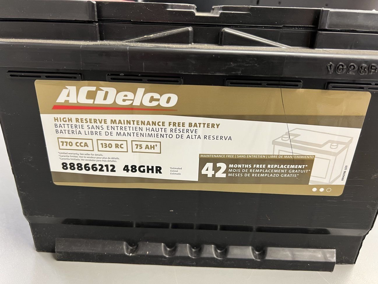

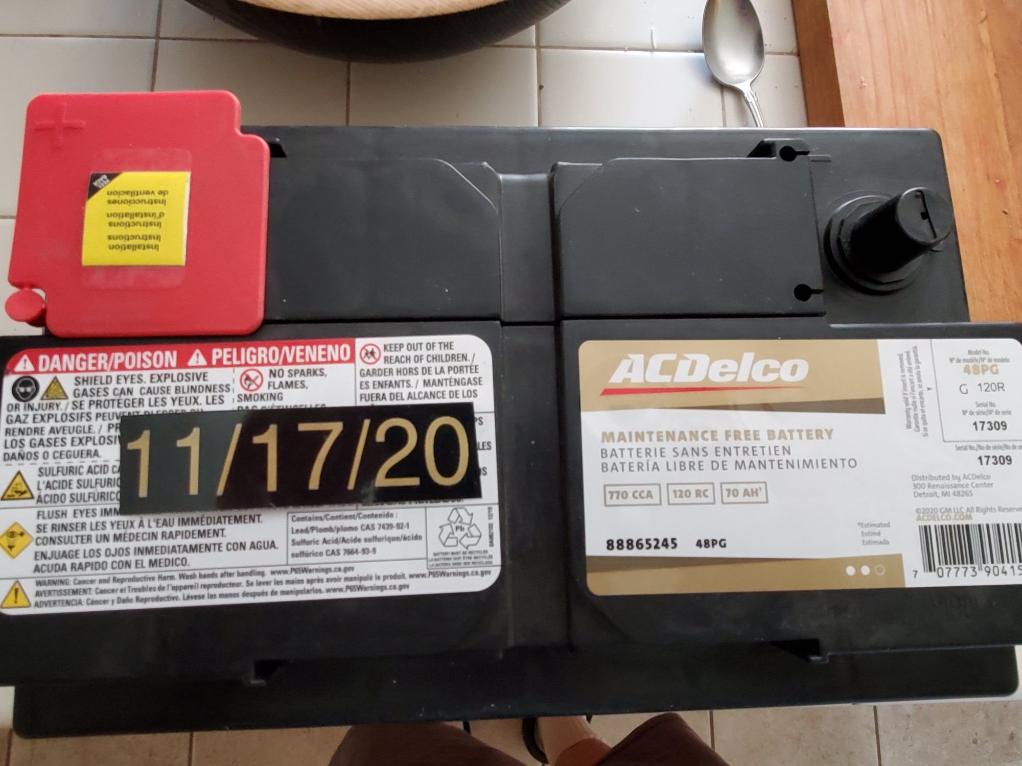

Originally Posted by BWF07
What battery is the most popular for the C7. In my C5 and C6 I used the Optima Red Top.
Both below are great replacements depending on which your can find. Your GM dealer will most likely have one or the other. These batteries should last you 6-7+ years and cost substantially less than the Optima Red Top.
