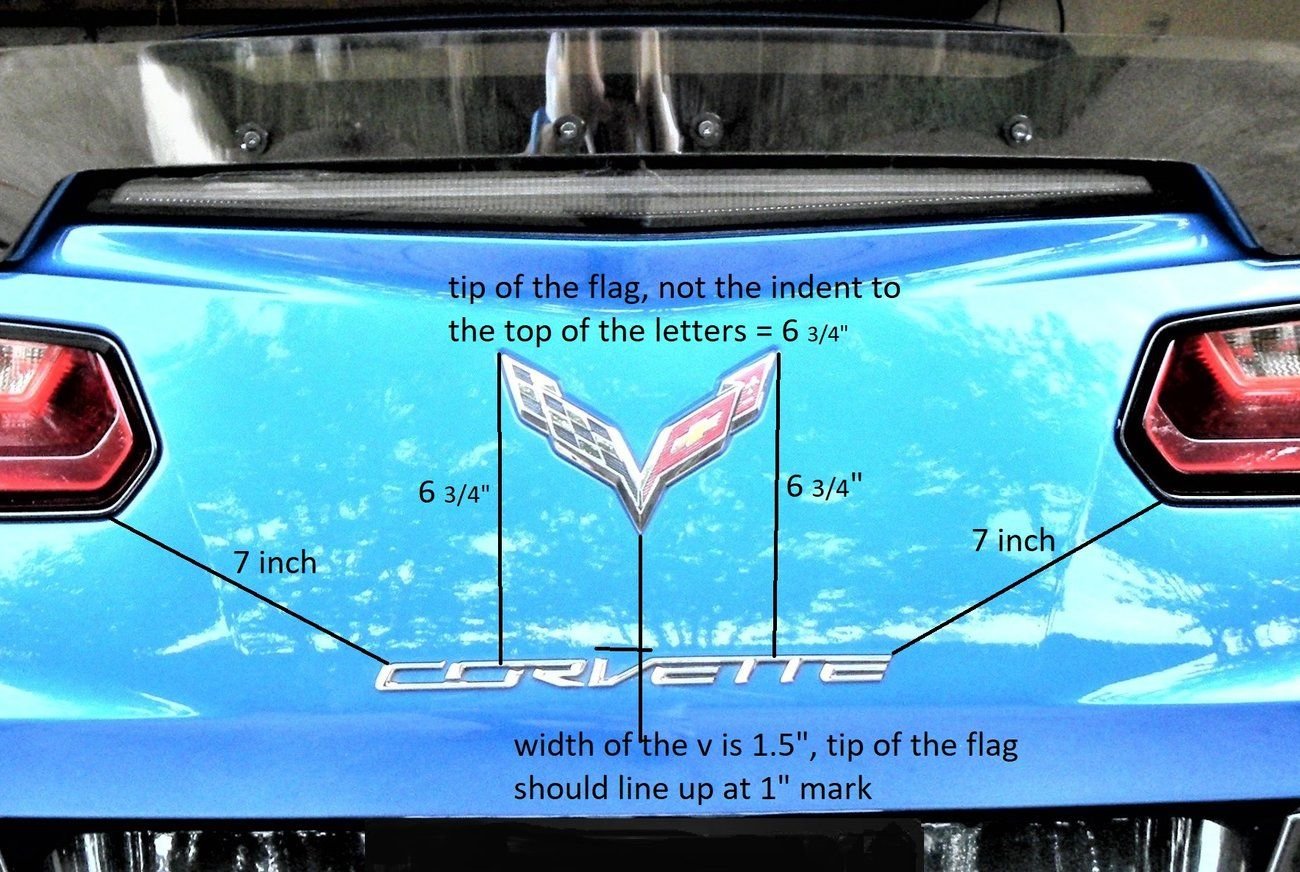

Can someone help me out? I need to get the measurements for the exterior flag emblems, interior seat flag emblems and the side stingray emblems. I'd really appreciate it. Thanks.

The badge on the nose of the car measures 6.75 inches from wing tip to wing tip. The badge on the rear and the badge on interior (convertible) waterfall are precisely the same size and measure exactly 6.0 inches tip to tip.The "sting ray" swimming on the front quarter panel is 5 and one eight inches from nose to tail; and 2 inches from wing tip to wing tip.
The chrome badges on the seat head rest measure 1.5 inches from tip to tip.
If you need the measurements in centimeters, we cannot help as we do not savvy metricity. Hope this is helpful.
