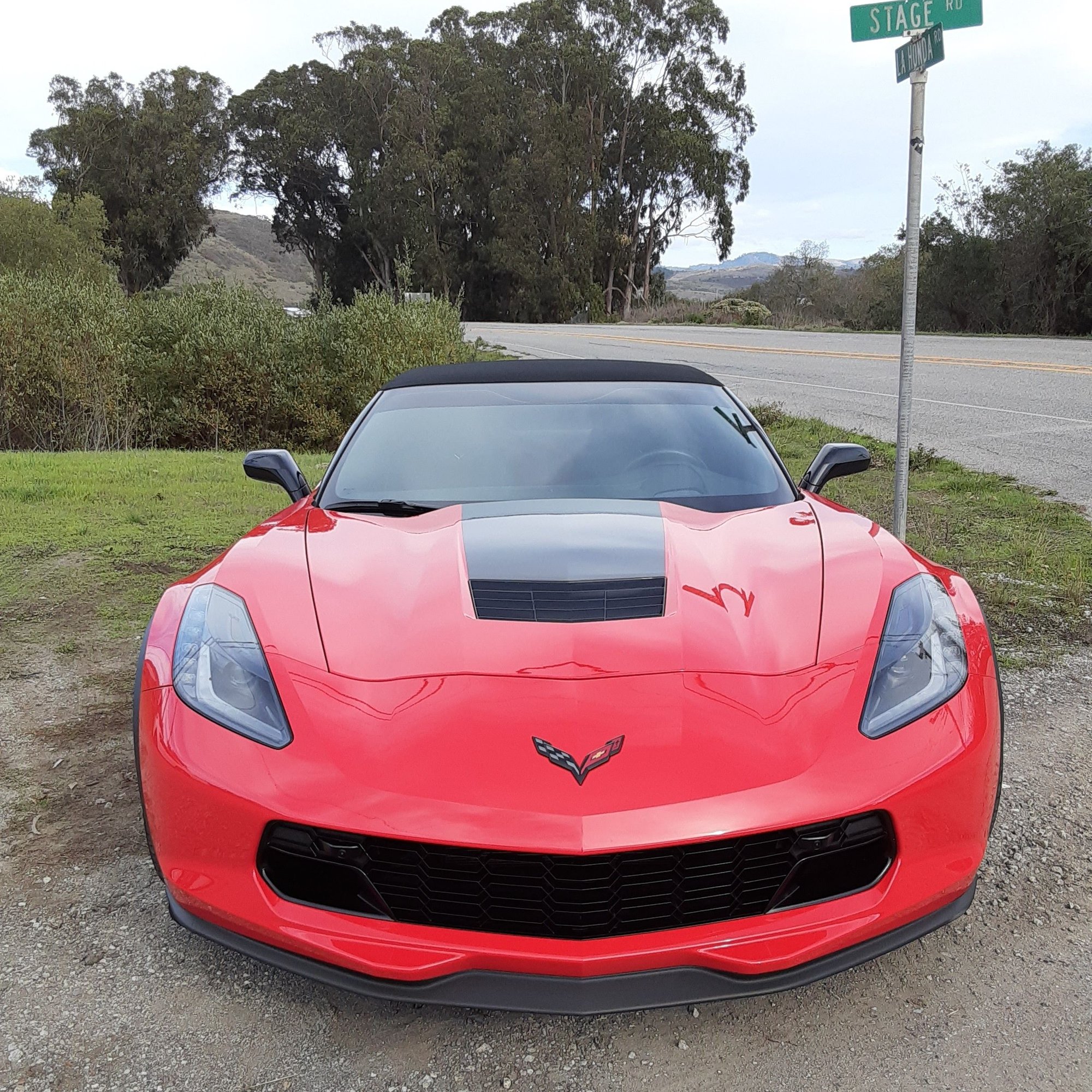

Has anyone put on the stinger stripe that VettStripes sells. If so, besides removing the vent from the hood was there any issues. I am wanting to do mine in the Carbon Flash

Shouldn’t be any issues. I haven’t installed their stinger stripe, but did have their fender stripes installed - perfect fit.

I did, and had no issues at all. Pretty straight forward install process, just take your time.
I removed the vent, hood up. I measured from the edges to the center point and used painters tape to line up the stripe (the outter edges). Use plenty of soapy water to move it around as needed. Get a good squeegee and either a heat gun or hair dryer. I worked some of the edges for a while (even after it dried and set) just to get the final little bubbles to lay flat.

Watched one being installed. Pretty easy once the vent is removed. Good advice above. Just take your time. It's really good looking and breaks up the color scheme nicely. Go for it!

Yes, great advice above. IMO the stinger strip really improves the C7 looks. Unless I'm mistaken, I believe VettStripes moved to Hawaii so delivery time may be longer.
