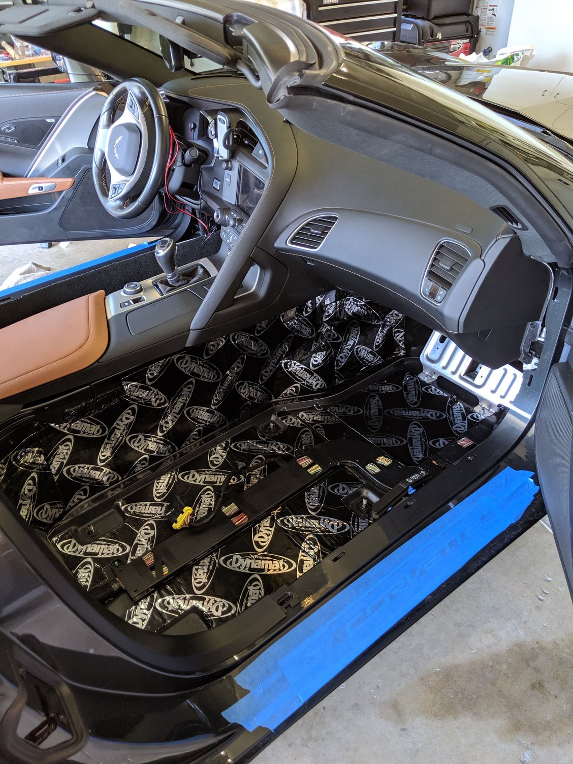

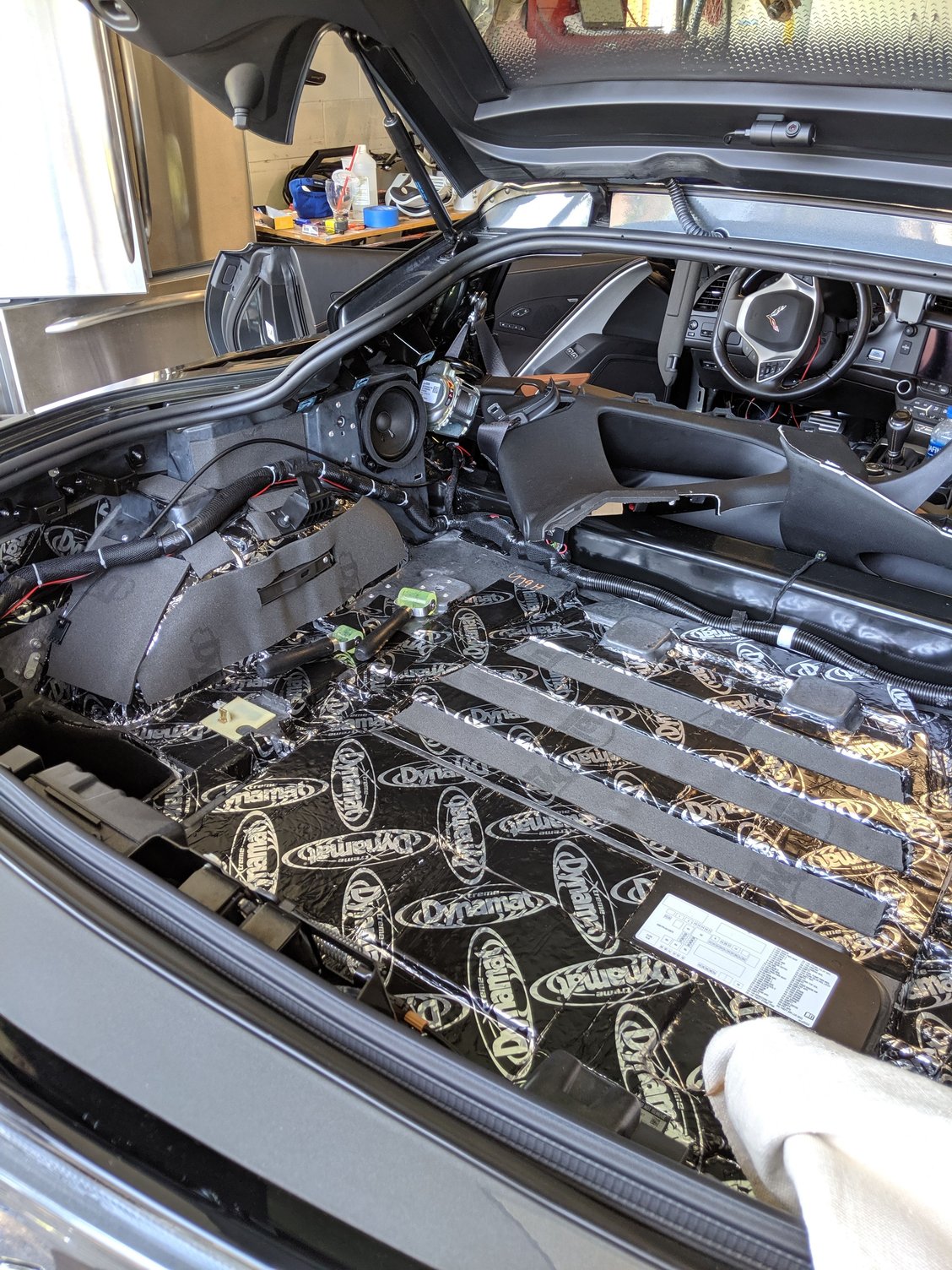

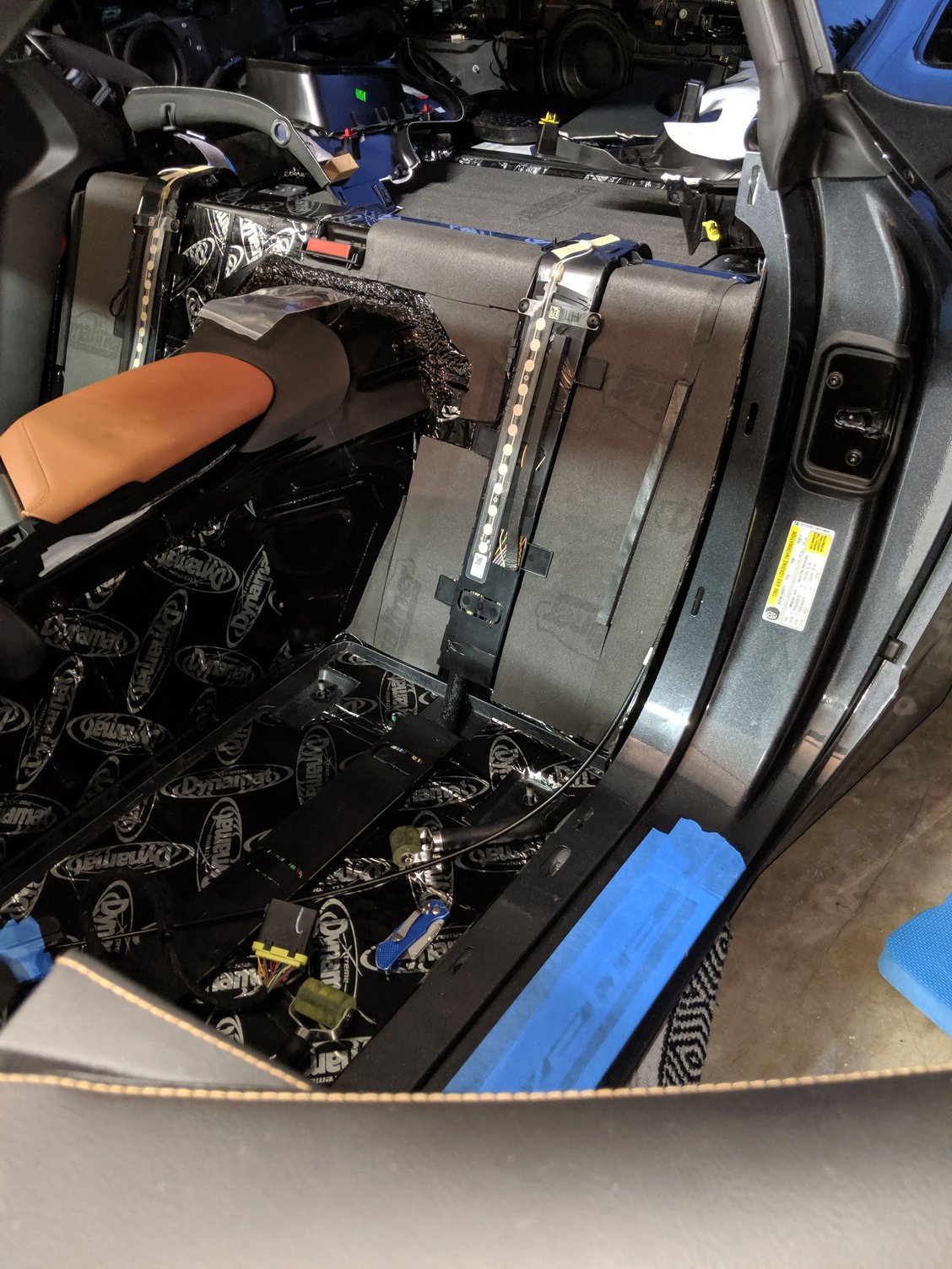

It was a lot of work for me. Here are some pics of the job:
This pic shows some of the thin foam installed over the top of the Dynamat product
Pic2
Pic3

Does look like quite the job but if the road noise and heat are reduced, then well worth the effort.
