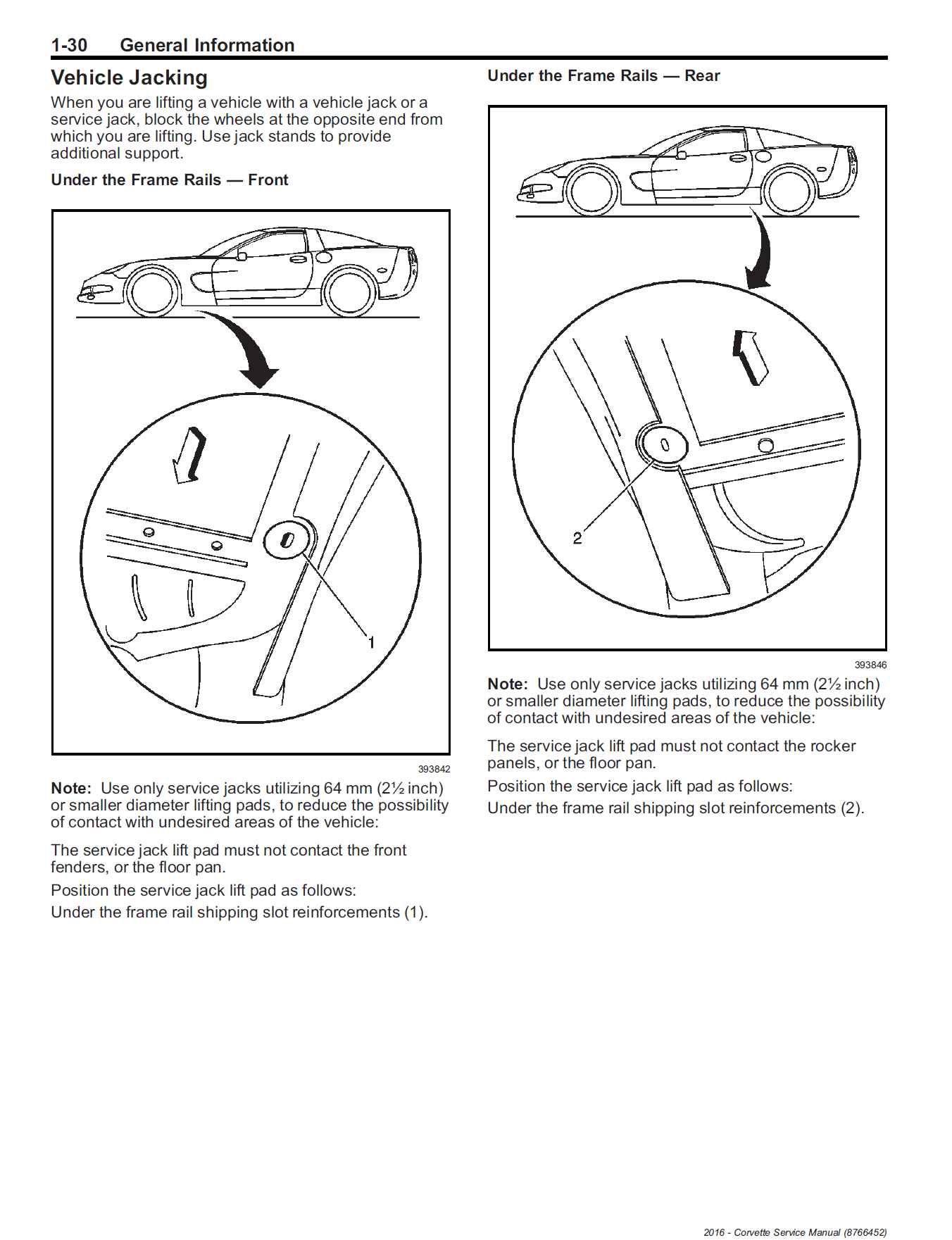

You really don't need the jacking pucks at the front shipping slot. The pucks are used to protect the plastic panel where it curves under the frame but there is plenty of clearance to place a jack pad in direct contact with the frame without damaging the plastic body parts. The pucks were originally intended for the rear shipping slots on the C5s since there was almost no clearance between the shipping slot and the plastic panel. On the C6 GM opened up the space and it became possible to not use the puck if you were careful. That was carried over to the C7.
This is what the C7 Factory Service Manual shows as far as jacking the car and using jacking pucks. Even though they are reusing C5 artwork you may notice the pucks aren't mentioned in the description or shown in the artwork.
Bill
