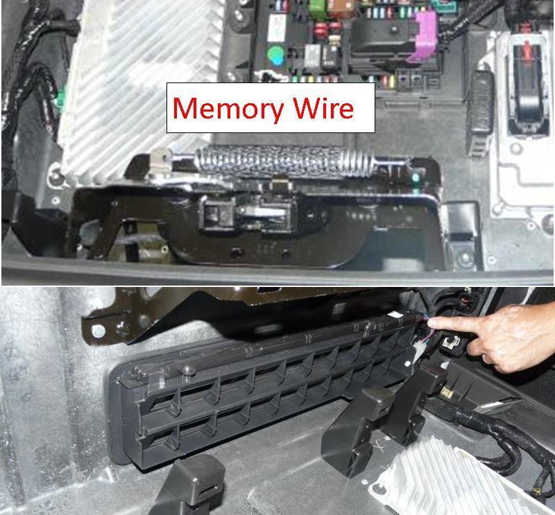

This is the Magic Memory Wire activated vent visible behind the license plate (there is an access hole.) Vent just not big enough for many cars. Worked for some.

That's not the memory wire. It's the spring for the latch.
You can't see the memory wire at all. It's inside the vent assembly.
https://www.motortrend.com/features/...c7-smart-metal
first off, as noted, that is NOT the "magic wire". secondly, I realize it is more than a software issue. you can buy the parts and install them but it would be no good without reprogramming the BCM to make it work. And yes simply opening the door and shutting the lid is how you make it work. Some of us like to tinker and mod our cars with later options that are a convenience and this would surely be one.
