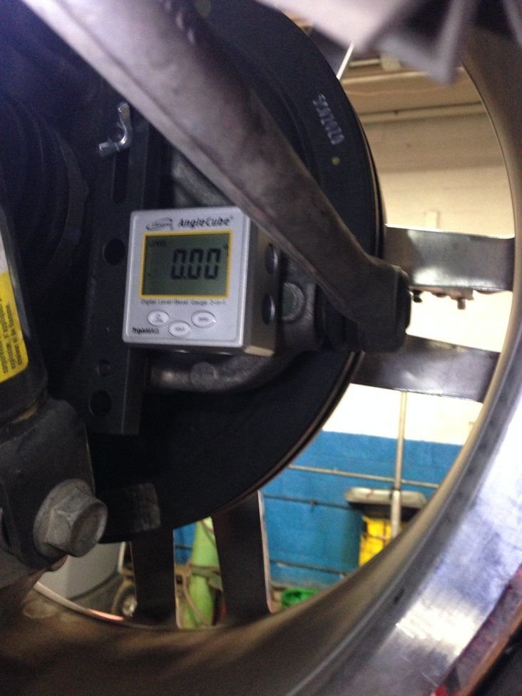

Cause for unusual wear on the right rear. Even wear other s and corrections needed to alignment.

Probably too much negative camber (tire tilted in at the top). More camber gives more cornering power but wears out tires in normal driving. You will need to find a shop that can measure rear caster which is very unusual. But, if they change camber w/o checking caster, the caster setting gets messed up. Search here for more info on rear caster.

Find a shop that has a Rear Caster Tool. Alignment Machines Can Not Measure or Display Rear Caster. Rear Camber and Caster have to be Adjusted Together.

I am pretty sure this is a toe issue, same on my Z, & toe was way off. If I remember correctly, caster will cause handling issues, but toe will cause tire wear, either way, you will need a street alignment for maximum tire life.
