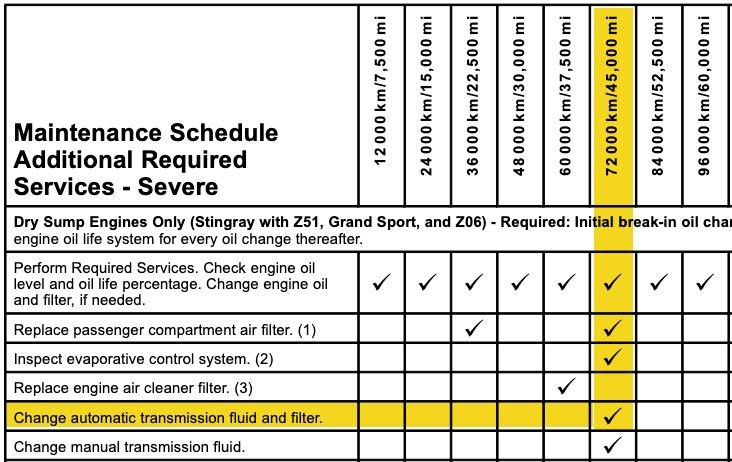

Default Trans service at 45K miles
Originally Posted by tuxxtoys
My daily driver C7 Z51 is up to 57K and I made an appointment to change the automatic transmission fluid. I think it's about due.
Here is a snapshot from the owners manual

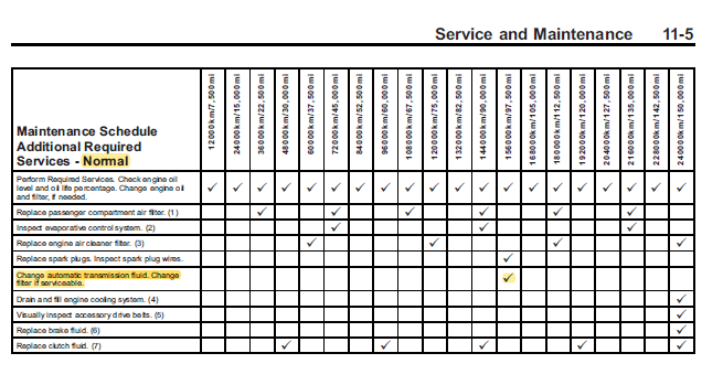

Here is the maintenance schedule for Normal Service in 2014:
