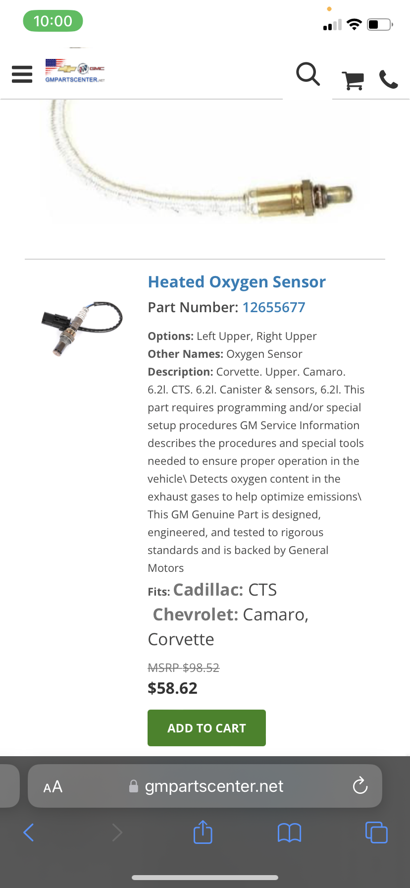

If it were me, I'd order the part #12655677. That would be bank 2 upper (closest to the manifold).

Got one on the way, thanks!
